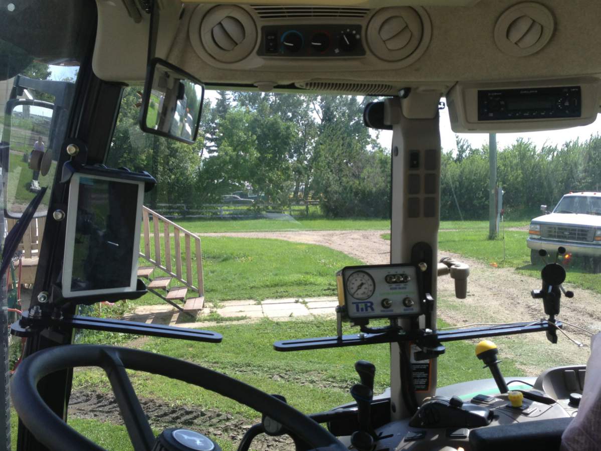

Sweet, what about monitor mounts? I know you can get long ones for the bigger tractors but I've yet to find any long ones for the 5000 series I'm looking at needing to mount 2 monitors plus an ipad holder and cell phone holder (both holders are from John Deere) I know the mounts for a mounting bracket is in a weird spot (front one faces side ways and is quite high and the rear one faces sideways as well and is a good height.)

Thank you for that link I got a cell phone holder and I pad holder from them (seems John Deere have made the cellphone and ipad holders official products and can order them with JD part numbers)
Here is a pic of mine all set up.

I have to ask what you are using the iPad for in the tractor?
   / 5m Add ons compatibility
I have an app called agDNA and what it does is keeps track of what fields I have done, the yields of each field, what needs to be done, it's GPS shows me my path on the field based on my attachment width, if I have a family member helping I can from my home computer or phone make up a task or special instructions on the fly and it will send it to the ipad and whoever is operating will get it and it will show them where and what needs to be done. The best part though is the app is free.
