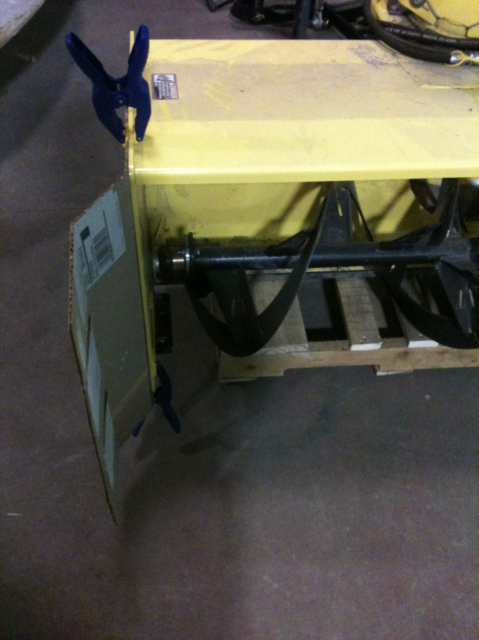

You'll love the 59 blower. I got mine late this spring and didn't get but maybe and hr use out of it then snow was over. But what I did use it it was SO much better than my old 3pt Meteor. I just pulled the 59 out of storage and have some steel on order to build "wings" for it to add more width and an electric actuator to run the chute spout. I'll get some pics later this week or next of the mods. Here's a cardboard mockup of the wings.....

Hmmmm... An electric chute actuator, that sounds like something I might be interested in doing myself. I have some stepper motors but maybe I could do it with a 12v windshield wiper motor and linkage.
How much are you extending the bucket with the wings? I just measured my tractor width at the ground, front and back and neither wheel is over 59" even with my rear wheels in the widest position. The blower itself runs about 59-1/2", outside to outside without the snow cutters on each side. Wonder why Deere doesn't use them?
What I found with my last blower is that you have to get the tractor right behind it or the tractor 'skews' to one side or the other, I'm wondering if the wings will help with this?

The wings will increase width by 8" total, with the amount of snow I have to move it just speeds up the process, also I have a circle driveway and when turning with the blower the rear wheels would "walk" up on the snow that hadn't been moved yet compacting it and building ice ridges. My old 68" 3pt blower allowed more movement of the tractor in deeper snow without the tires touching the banks.
