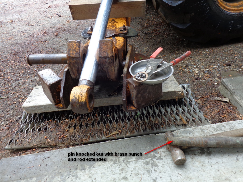

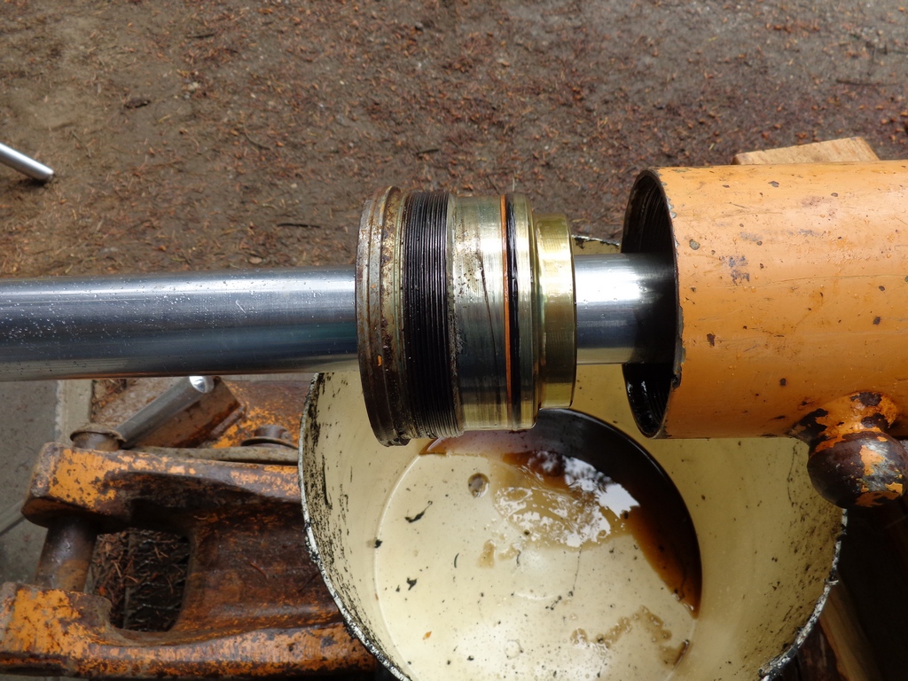

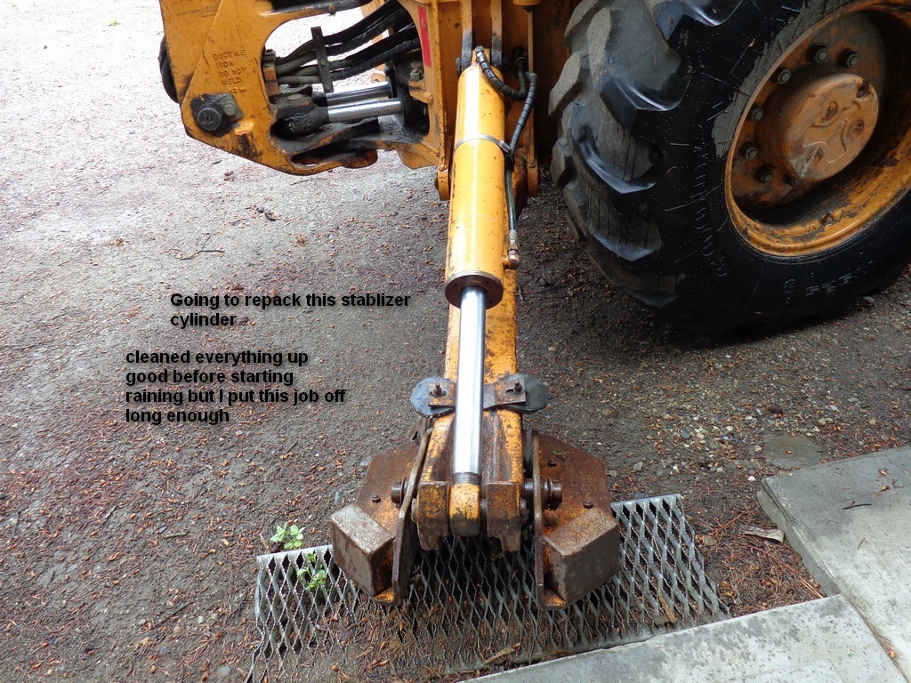

Leave them on the backhoe just take the cap off the gland pull the rod and take them in .
Some times I use the hydraulics to push the rod out in this case I just pulled it out.
