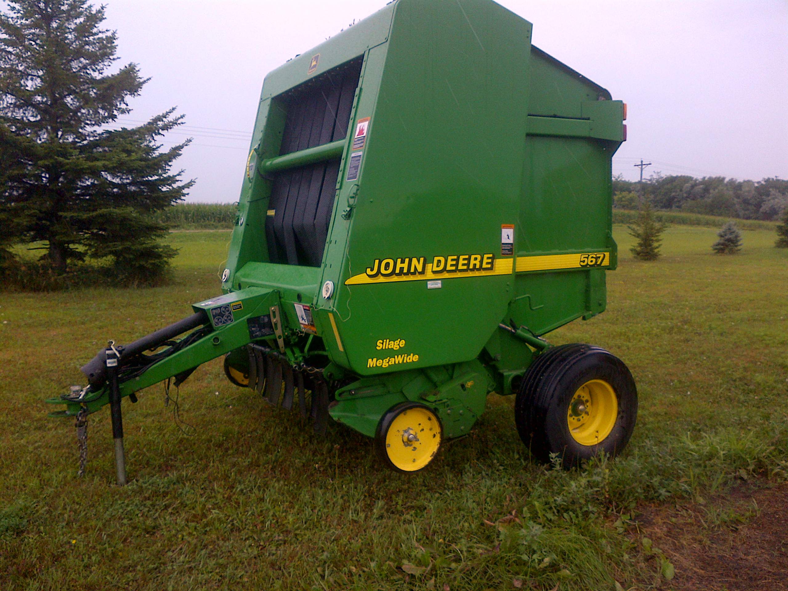

Tx Jim, I'll have to check all the connections. It first started towards the end of the tying sequence on the first bale, and did it there again after the next few. Then it started showing the battery on the monitor off and on during the accumulation process, and depending on if it was on or off I would get the audible "almost full" and "full" beeps and auto-tie. I unplugged the monitor, plugged it back in and moved the chord so it was straight out of the outlet, and it worked great for the next 5 bales. Then it started again. Twice during manual tie, it wouldnt start the tying and I would have to keep pushing the button and then the tying would begin.

Several yrs back I had similar problems tying hay on my 467 using my old JD 4255. I had to bypass the factory tractor installed wiring harness and run a wiring harness with a circuit breaker straight to battery. Long story/short story=problem solved.

Talked to the Service Manager about the issue. After describing the issue and discussing my tractor, he was concerned the 5093e's convenience outlet wiring wasn't heavy enough to handle the draw the actuator needs (which he said is quite heavy). He wants to provide me a "bypass" set of wires to test that theory and if it works and cures the issue then we'll know the tractor convenience outlet was the problem. Unfortunately, I'm done baling for 2013 so we'll have to give this a try next summer. He says he has seen this before and the bypass was the cure.
As a side note, he said he didn't have any other customers baling with this small of a tractor. I guess I live in BIG tractor country!

That's exactly why I had to run a wiring harness for monitor straight to a battery on my 4255

Same here wiring harness runs straight to battery. If yours is a small tractor hate to see what they call mine:laughing:
Mine was a different number JD baler but same cure.
