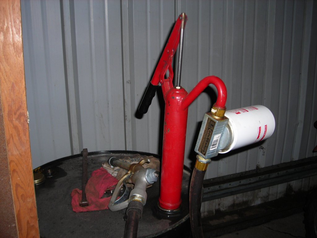

I have a steel 55 gallon drum and use it for my off road diesel. I also use a hand style pump and a standard fuel hose with a filter on the pump discharge. I haven't had any problems with the set up. The system works pretty good for me.
