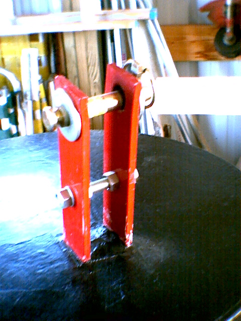

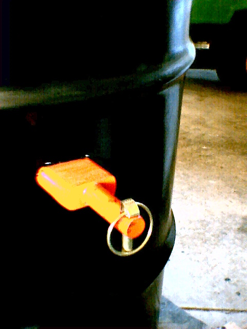

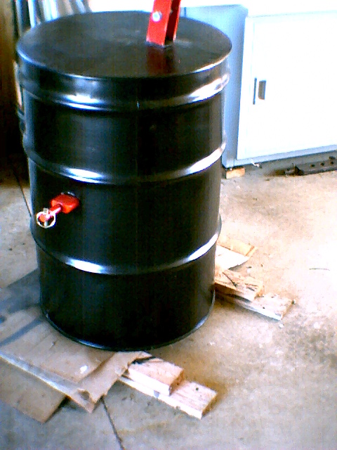

A few shots of mine. The top link connector was from a stabilizer bar I bought at TSC and cut in half. The only think I would do different would be to add a few PVC pipes to carry shovels, rakes, etc. When I built mine, I was thinking "snow plow ballast". But when using it for a "FEL Ballast" the pipes would be handy. It's plenty heavy as is, so losing some weight due to the pipes would not be an issue.

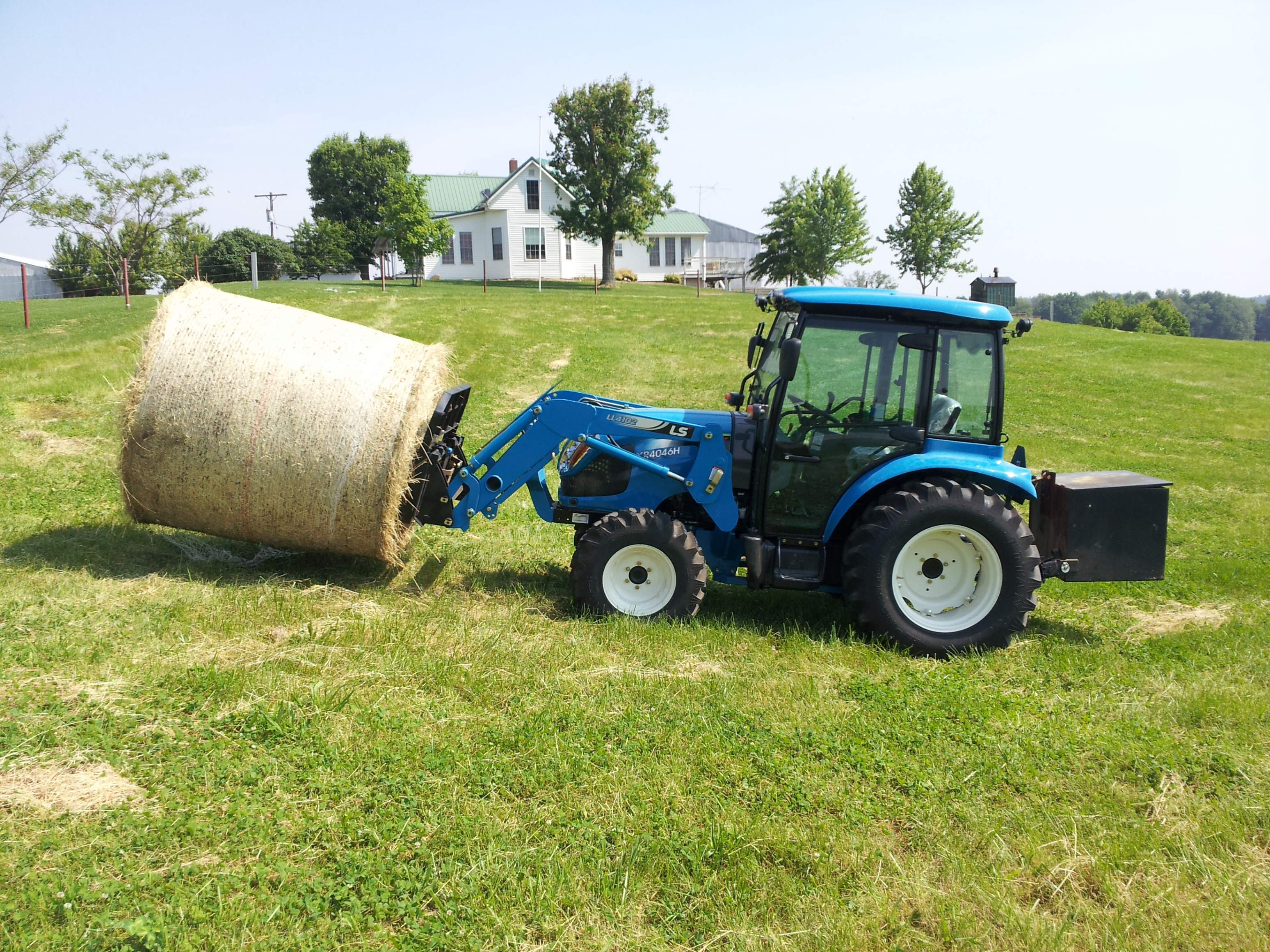

I just drilled a 1/4" hole in the bottom of each of mine to allow water to drain. I only filled the concrete up to 3" from the top to allow a place to carry chains and small tools.
