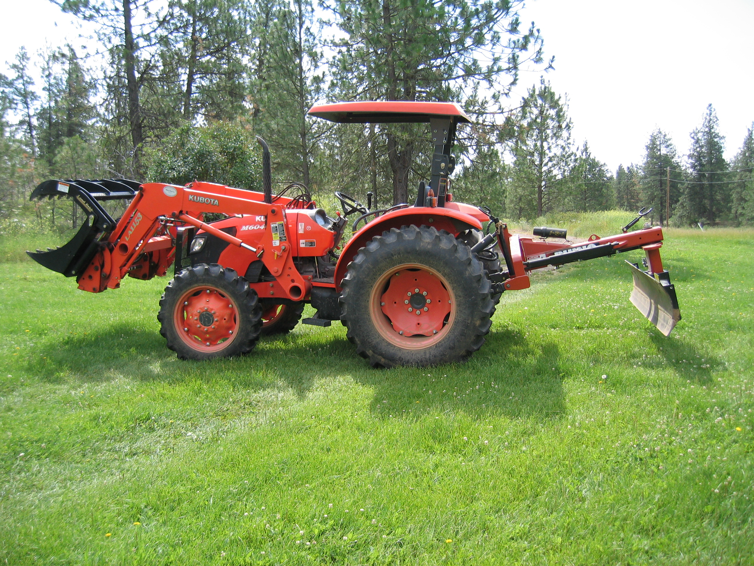

If you are going straight up/down your slopes - most any size tractor will do this. It's the turning while on the slope or running across the slope that can quickly get you in trouble. If you are considering the Kubota 60 series - look at the M6060.
Don't know how long your driveway is. For 27 years I used a 3-point blower on my tractor to clear my mile long gravel driveway. It was a pain in the neck, literally, driving in reverse for that long a time - but it did an excellent job. Clearing driveway, mailbox area & yard - - three and a half hours.
I now have a Kubota M6040 and heavy duty rear blade. Same scenario takes one and a half hours with the rear blade.
This my tractor - outfitted with grapple and rear blade. The rear tires are loaded with RimGuard. In this configuration it weighs - 10,100#.
