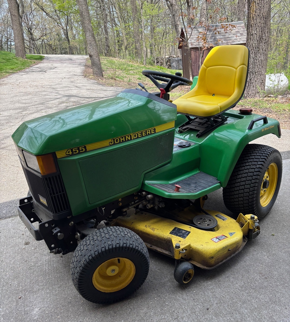

Mow 6-7 acres now with 54" deck. Prefer the AWS for faster mowing.
