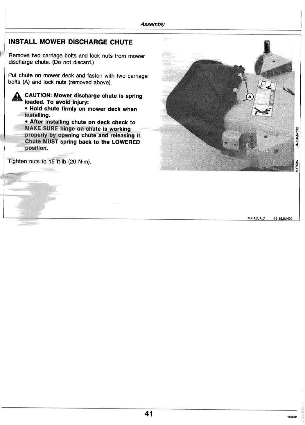

When I bought my used 455 in February, it came with the blower attached. Today I went about installing the mowing deck (54") for the first time. I am going about this blindly as there was nothing in the owner's manual about it's installation. None the less, I think I have it on correctly. There is however one problem: the previous owner must have had a bagger attached, therefore removed the discharge deflector from the deck. I have tried every concievable way to re-attach this but have come to the conclusion tht I must be missing a part or two.
Are there any of you who could post a pic of your deck so I can see how it should attach?
Thank you in advance,
Gary

...a spring-tensioned hinge and several bolts with locknuts...? I don't know for certain, but there are worse things to try to overcome. I know the 60" model has a similar assembly. I will look tomorrow and check back to see if you still need a reference.

I'll post a pic tomorrow if someone doesn't beat me to it. I leave mine off the deck. The bracket bolts to the deck with two bolts, as you learned in the other message. Then there is a long hinge pin that goes through the bracket and the molded shield that is spring loaded.
Are any of these parts missing? Or what do you have? pics?

I snapped a pic of the shield unattached to the 54" deck, but showing the two bolt holes that hold the angle iron pinned to the shield.
Questions? The pic shows a plastic tie holding the shield and the belt shields together for storage. I keep the top of the deck open so I can keep it dry and free of debris (blow it clean after each mowing).

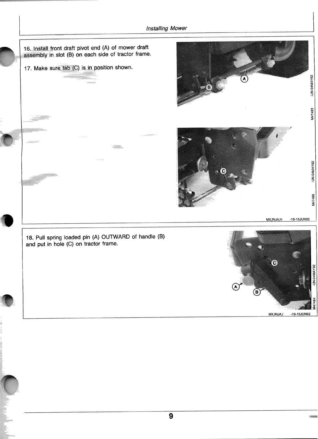

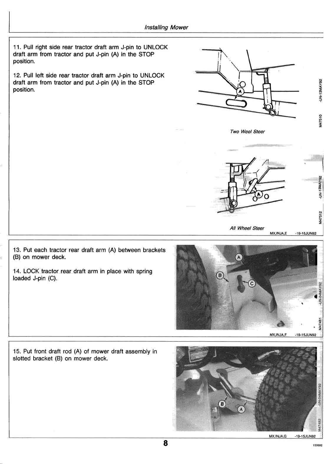

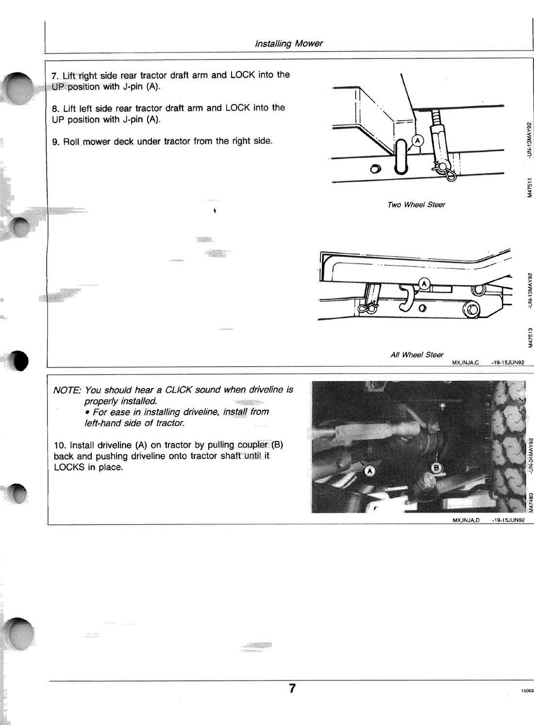

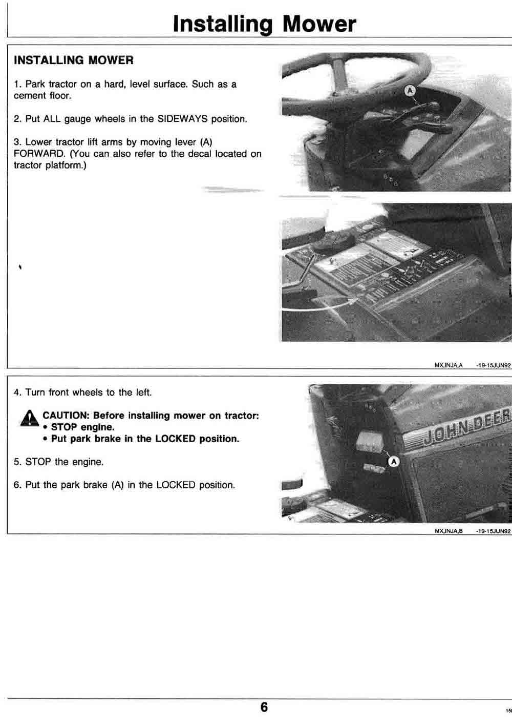

Gary,
This may help until I can do better. Tried to email the manual scan but had problems with your email account. Apparently the attachments were too large.
   / 54" mowing deck for 455 #7
Re: 54\" mowing deck for 455
Mounting the deck, pg 6
   / 54" mowing deck for 455 #8
Page 7

Page 8

   / 54" mowing deck for 455 #10
Page 9
