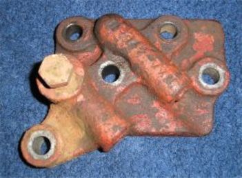

   / 54 Ford NAA 3 Point Hitch Stopped Woking #8
there is a single blank cover on a naa hyd top cover .. it is under the right front of the seat. there are 5 bolt holes and there is a single pipe plug in it. removing this plug will allow oil to come out if the system is making flow.. if no oil here, you may have an non primed pump... which is what we are trying to determine.
the fill 'bung' hole is on the left side of the seat, mid way back on the hyd top cover... and is NOT the one you need to remove...
soundguy
#9
As soon as I got home from work, I removed the correct plug and checked things out. Before starting the tractor up I noticed some oil just below the plug ending point. Then I started up the tractor and checked again. NO Difference! There was the same amount of oil there (maybe slightly less) and no stream of oil. I then increased the nut on the pump for faster flow to see if that made any difference, but that did nothing. I also tried moving the lift adjusting lever just to make sure, still nothing.
John >>
   / 54 Ford NAA 3 Point Hitch Stopped Woking #10
the 3pt lever won't effect anything as it's not even getting oil to the top cover.
try a air blow gun with a rubber tip and put it up to the port the dipstick goes in onthe hyd sump, and give it a few psi of air while the engine is running and that plug under the seat is out.
