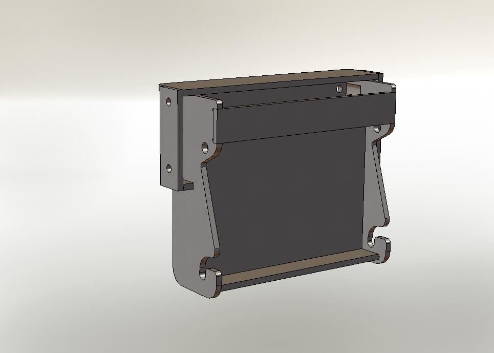

Well it has taken me much longer than I anticipated, but with a two year old and a nine month old I just don't have as much free time as I used to!
I bought this JD 54" hydraulic lift and turn plow over the summer. After I picked it apart in my barn I modeled up a 3D CAD file of the tractor frame and plow frame. From that I generated the 3D file of the adapter I made. After a couple weeks of tweaking the CAD model I started fabricating. I did everything at work (in the evenings), so I don't have many pictures of that process, but the final result is below.
I have not used the plow yet, but I am hoping it will be a big improvement over my current snow removal machine (1961 wheelhorse)
As soon as we have snow I will let everyone know how it works.
Best!

Thanks for the compliments guys. If I could have bought a plow up for $1300 I would have seriously considered it, but the prices I kept getting were $2K or more.... and did I mention my wife really wants a mini van? Anyway, here is another pic of the adapter. Hopefully it will help others to come up with their own low cost (high labor, but its fun!) alternatives to OEM equipment.
Best.

Thing,
Nice model. What software did you use?
   / 54" Deere plow on GC2310
SolidWorks 2008
