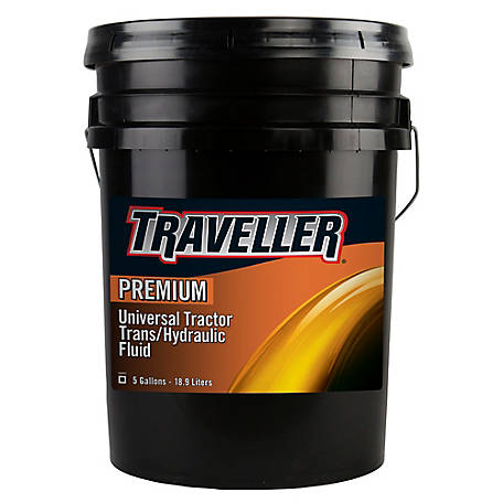

Nothing added to the fluid. It’s travelers from Tractor Supply, has a dark tint to it. Ran the shredder yesterday and it was leaking from the PTO seal. It’s at the dealer now. Waiting for a call after they “diagnose”. I’ll be quite irritated if it’s not fully covered.

This is the stuff I use:
it's very light gold when you look through a lot of it, and I can't see it in my sight glass.
