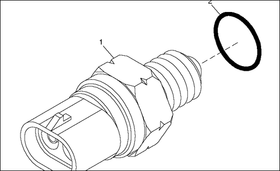

It's highly possible that the neutral start switch isn't making good contact. I don't know NS switches exact location but it should be on the top or side of trans case. One could check it's operation with a VOM.

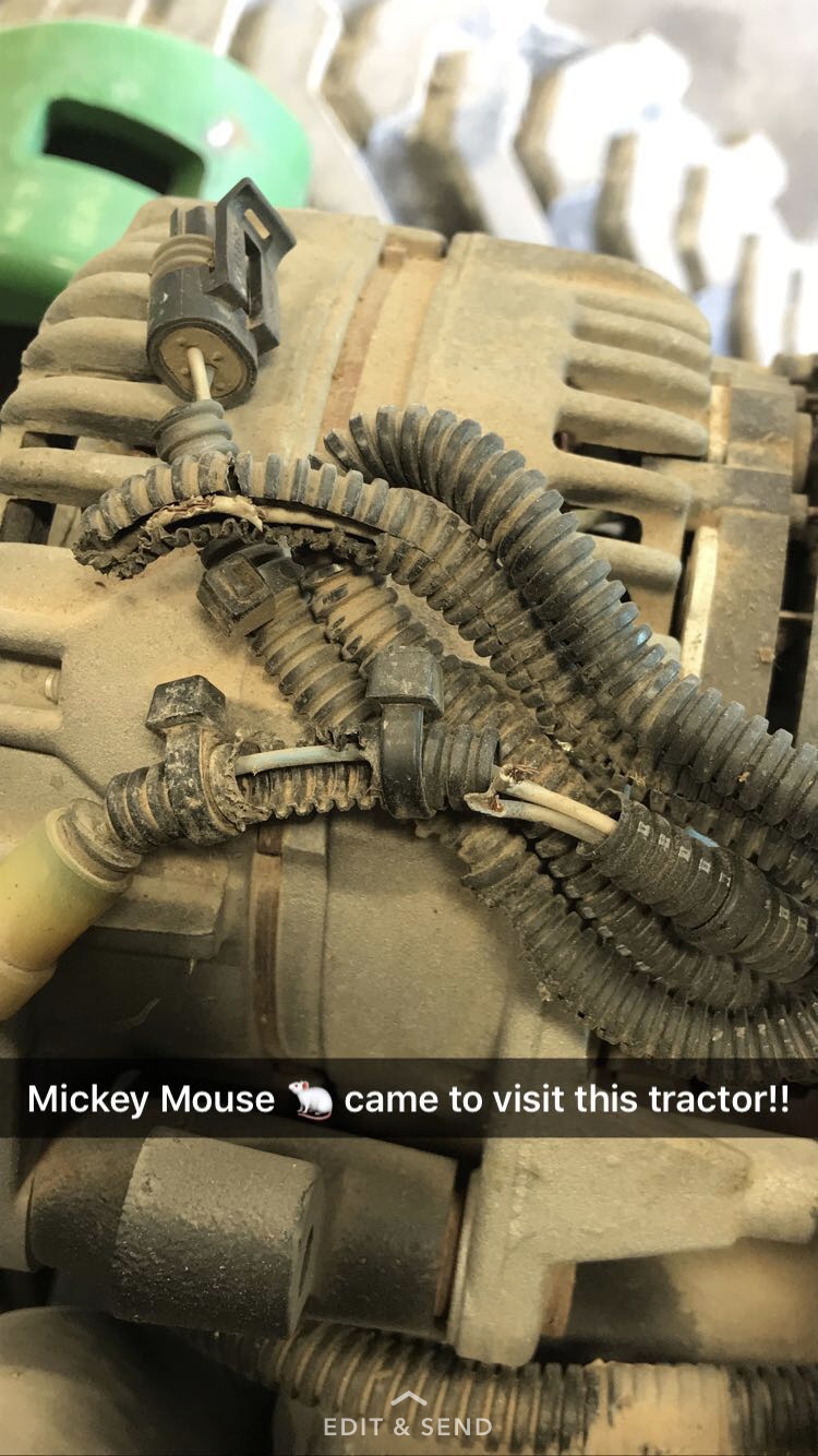

SOLVED
One of the smaller wires on the start relay had been chewed in two.
-Matt
/ 5103 Starting Problem #7
Find out what chewed the wire and deal to it - or it'll be back for a second helping of 'insulation smorgasbord'.

I'm not familiar with your model of tractor but I suggest for you to inspect trans case for a switch that resembles switch in photo below.
