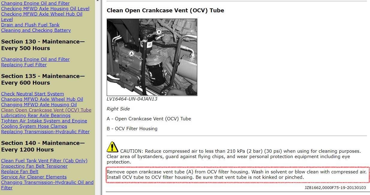

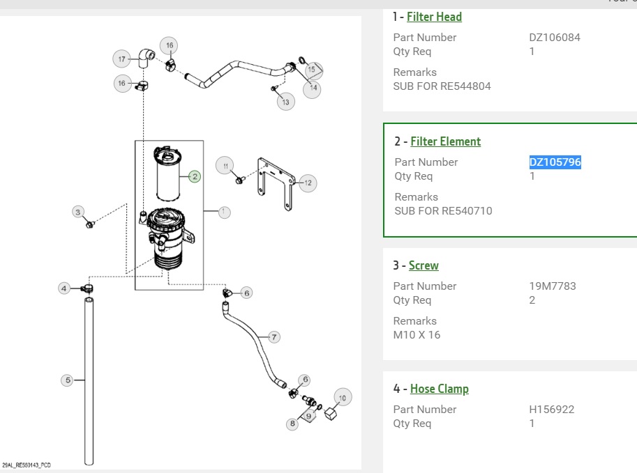

Anything like this?
From jdparts
And mention of cleaning the ocv tube in the manual..
   / 5085e
Anything like this?
From jdparts
I took the tube off and it is nit clogged. Started tractor and very little air is coming from filter. Have someone coming to change filter. I have no knowledge of how to get the filter out. There is no room above top of filter. Bad design.
