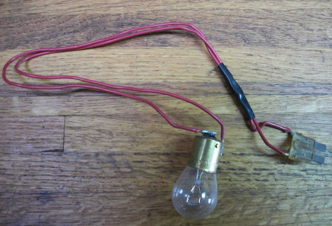

Rig up a 12v bulb to stick in place of the fuse. When there is a short, that bulb will be lit.
As suggested, pull the sensor and if the light bulb goes out, you have identified where the short is at.
Rig I made up to test for shorts. Has saved a lot of time looking for shorts.. especially the one wire above a headliner going to the tail lights.
