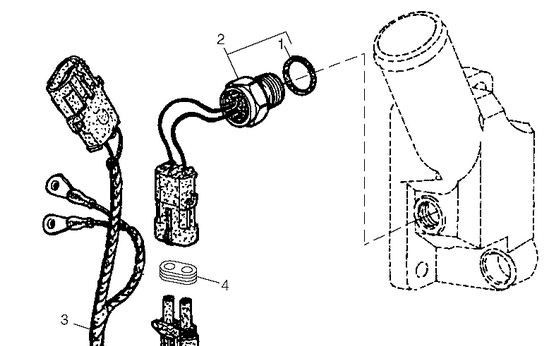

Sounds as if cold start sensor has shorted out. This sensor has a long history of failure since the mid 90's. I think JD must enjoy the $$$$$$ this failure generates. Disconnect sensor,install good fuse & engine should start. RE503242 Temperature Switch ADD 49.58 USD

Tx Jim, if the sensor has shorted out will the coolant temp gauge register normal? Should not I would think either pegged high or Low? I know while driving tractor the gauge was indicating normal temp. You are suggesting if shorted when I turned the start key?
Is there a way to confirm it shorted by measuring voltage with key on (engine not started). The reason I am asking is about a year ago I had a problem with starting and same fuse had burned and turned out to be defective starter. There was a JD Product Improvement Program related to the Bosch starters. After replacing the starter, replacing the fuse and cleaning battery and frame ground connections, it ran fine for a year. My temp gauge has been reading fine for a year. That means the last failure was not the temp sensor shorting, correct? The dealer that swapped out my starter part (I installed it) said the defective starter caused the 30 amp fuse to fail?
I hope it is what you are saying. I guess you already answered my question; if I just disconnect the sensor electrical connection and it starts, that confirms what you are saying? While running , what will the coolant temp gauge read with it disconnected?

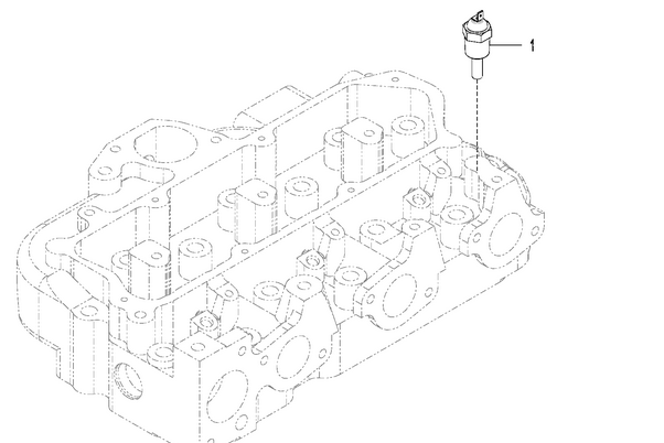

My understanding is RE503242 has no affect/control of temp gauge as temp gauge is controlled by another sensor located in cyl head.
