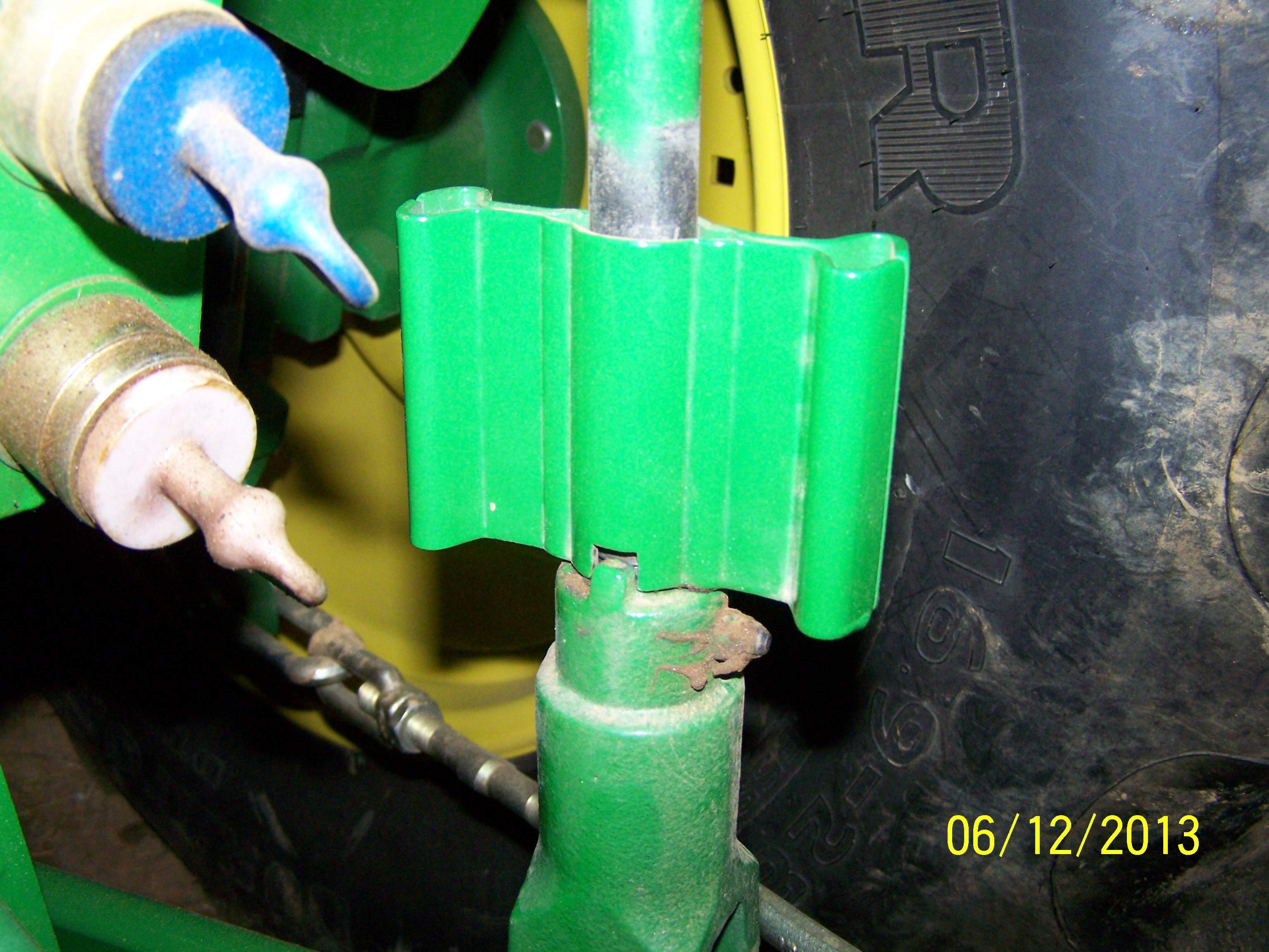

On my 5065E when not using the 3-point hitch but pulling a disk/baler, the right hand side adjustment link vibrates loose. It's done this several times to me and I caught it before it came completely apart. However, my Dad baled hay with it and was not so lucky. The handle is now in a 15 acre field or a hay bale somewhere. I'm trying to understand what I can do different to prevent the vibration from fully extending the screw and coming apart. All my other tractors are antique and have the crank handle, so I'm looking for suggestions to prevent losing some more pieces. Is it possibly a design flaw that would be under warranty? I've (hopefully) linked the JD parts diagram of the pieces I'm referring to (far right diagram).

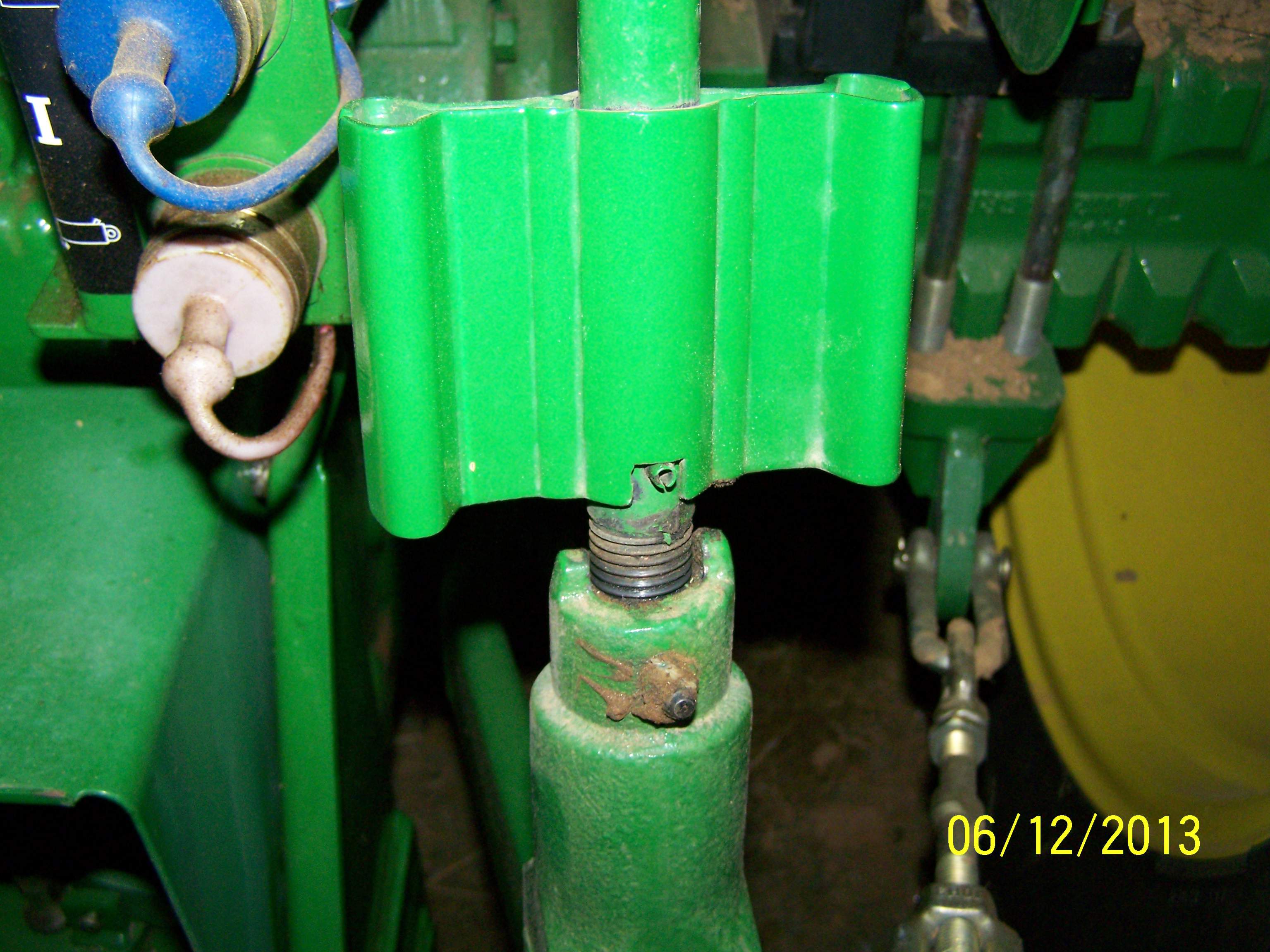

5055E 001.jpg5055E 002.jpg Is it in the lock position?

I make sure to put it in the lock position but it doesn't seem to stay there for very long, depending on what I am doing.
If that's the case, you need something very high tech, like a bungee cord or piece of wire, to keep it pulled down, in the lock position. Frankly I'm suprised that the lock would disengage, seeing that it would need to fall up, but stranger things have happened. The squared off protrusion in the casting should lock into the notch of the part you turn. If it's worn round you could build it up some, by brazing. The high tech method would be easier.:laughing:
Duct tape or baling string.....That's the approach I'll be using when I get the replacement handle to keep from losing it again. The tractor only has 100 hours on it, so I don't think the squared off protusion is rounded.

I've got the very same adjustment "handle" on my 5075M, too. It's stuck on top of the rectangle, metal lock and doesn't really move or slide very easily (but, it's kinda dirty, too). I'm wondering if your's is bent or out-of-round and doesn't slide all the way down on top of the metal lock tab.
If it doesn't fit the adjustment shaft just right; it won't stay in place very well, either.
