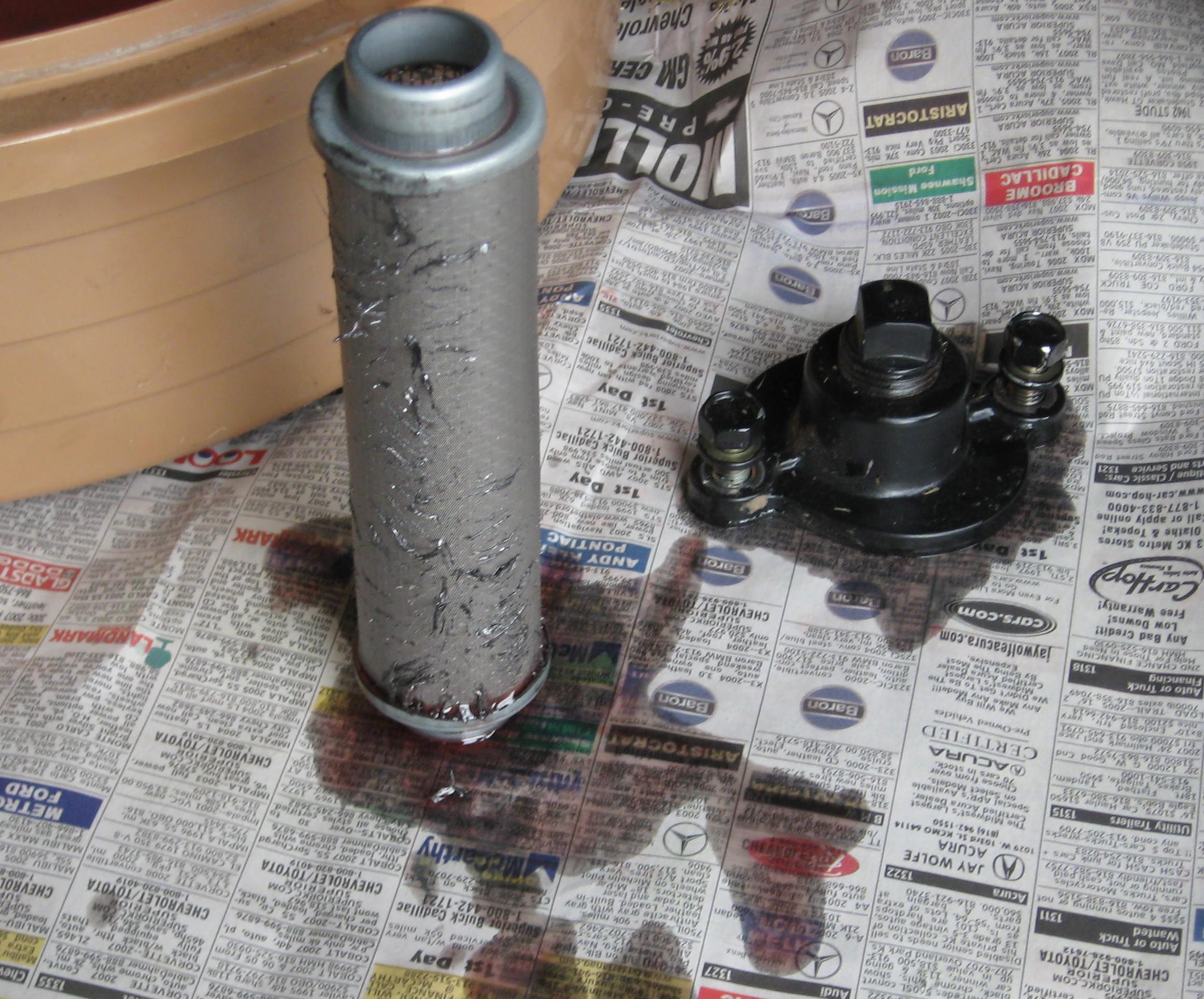

Just did my 50 hour today,actually 49.1:). I'm assuming because those 49 hours weren't "real hard" hours is why there isn't much on my screen,but anyway,I'm surprised at how relatively clean it was.
I didn't have a strap wrench for the spin on fuel filter either,which really made it very difficult to remove. I'll know better next time.
The factory hydro fluid was red.
Start to finish,it took me just about four hours. Everything went pretty smooth,except the fuel filter. So hopefully I'm "good to go" for another 150 hours.:thumbsup:

Yeah, that's about what my screen looked like at 50 hours also.
I noticed a big difference in HST performance once I switched the factory fluid out for the LO-VIS - much more responsive, especially when cold.
You replaced your fuel filter at 50 hours also?

Looks good Greg, screen looks normal for the first 50hr service. They use the red fluid to spot leaks easier...It is a whole lot easier to see in the sight glass for sure.

Cool.. cold.. colder --- makes it goooo sloooo :D
(They normally ship with standard viscosity HyGard; not lo-vis HyGard.)

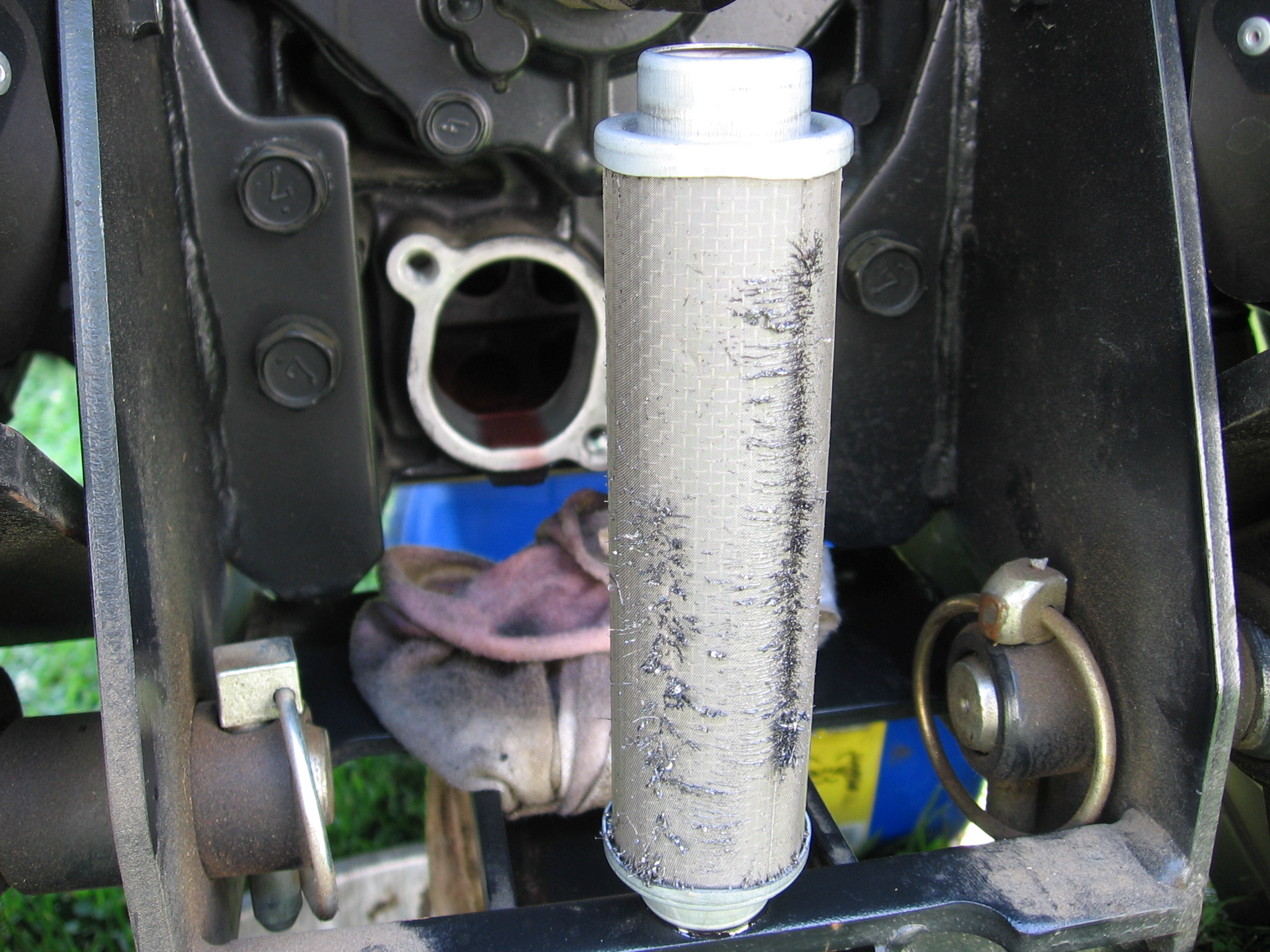

The factory oil looks prettier and smells better than the replacement stuff. Almost like grenadine.
Here's my filter at 50 hrs.
