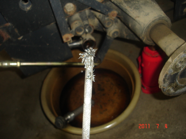

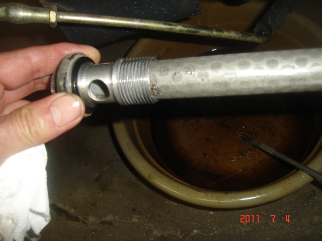

The new GCs might be different, but mine has the behind-the-rear tire suction filter as described above. It can apparently be removed without removing the tire, but having the wheel off does make it easier to get at it. Here are a couple of pics of my 50-hr service; the odd pic is showing the metal filings on a magnet, with the tractor behind. You can see where the suction filter came out in the background, just over the top of the magnet. Should be ready for my 500-hr service real soon. Filling the transmission on my 2310 is a LOT easier with the backhoe off, BTW.
Also, make sure you have a large enough drain bucket- there's a lot of fluid in there!

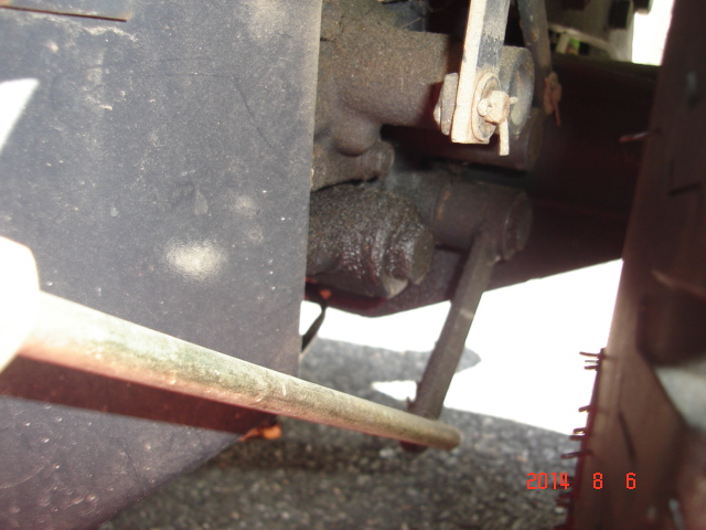

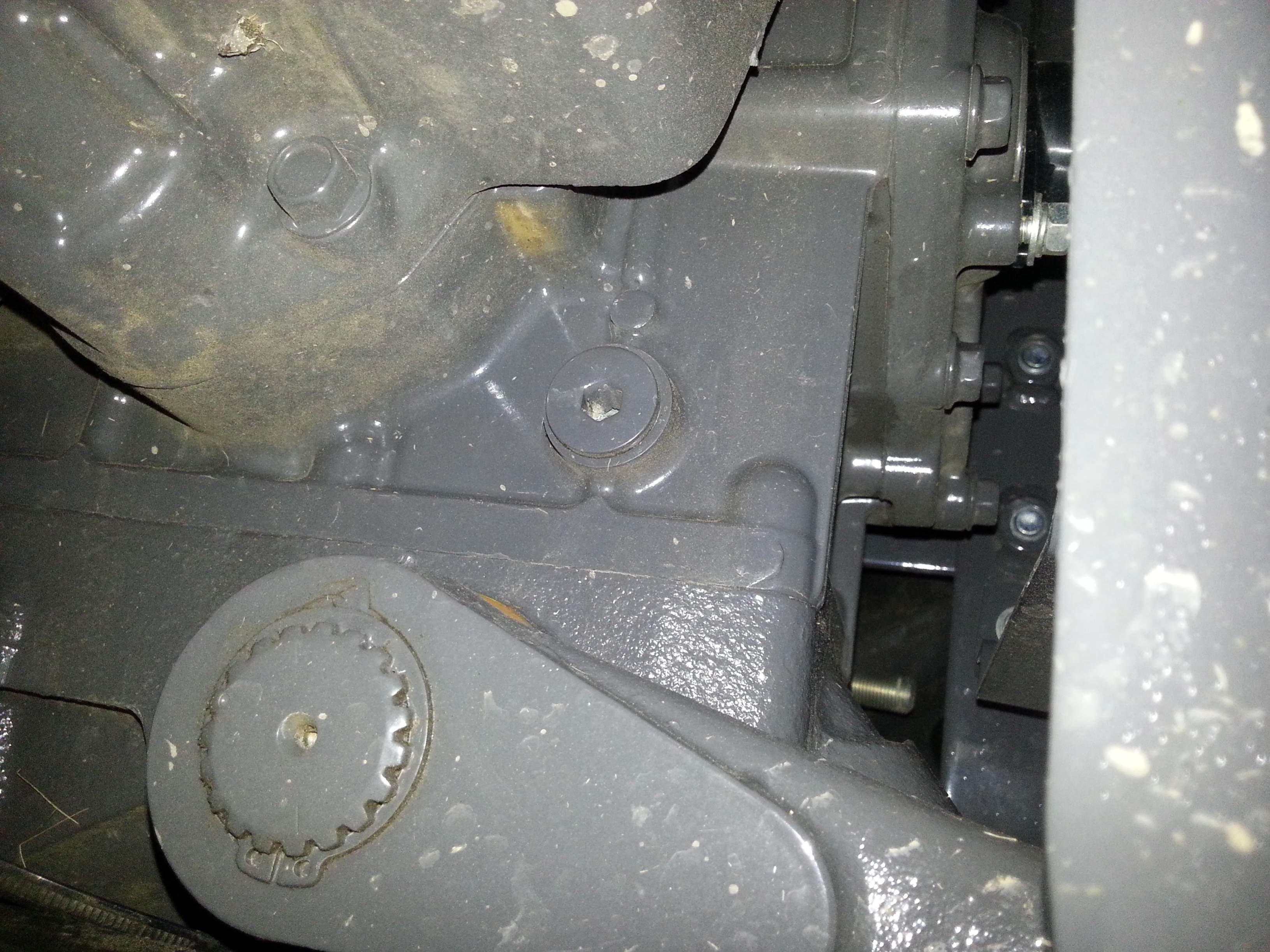

No. You can see where the strainer goes in this photo, from Irving.
The opening it threads into, is the dark circle, at the end of the magnet. It has a large hex head. located at the 8 o'clock position looking at the end of the left axle.

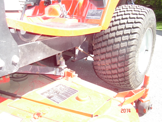

Coyote, here are a couple of better pics, looking rearward over the mower deck, inboard of the left rear tire. It's a bit damp with oil.

Thanks !!! I found it easier to see with wheel off.
