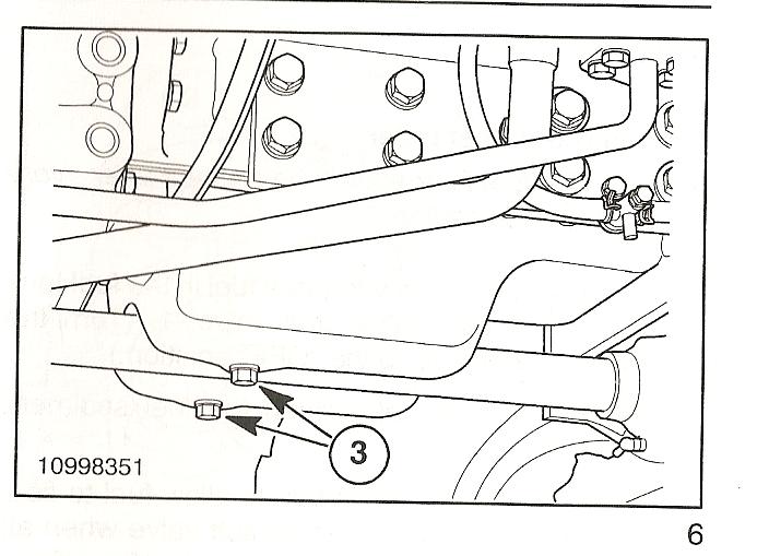

I now have 49 hours on my 45A -- Should I do the 50 hour maintenance or take it to the dealer? I can check fluid levels, change oil and grease fittings but are there any magic tests they do at the dealer that I would not know about and does it effect the warrantee

There is nothing magical about the 50-hr service. You can easily do everything yourself. If you don't have any warranty repairs to be done, I'd sure recommend doing the service yourself. You'll save at least $100 and the hassle of hauling the tractor.

Just to add to Neil's excellent "pic-tutorial," I believe your tractor has two engine sump drain plugs (one on each side of the fwd driveshaft) and also two sump drains for the transmission oil (which does not get drained at the 50 hr). Only the main hydraulic filter and HST filter should be changed. Since your tractor is a 45A, you don't have to worry about the HST filter.

You are right on the two plugs. Also I noticed a number of differences in the recommended changes for the 50 hour.... One said check the fuel filter, one said replace and the the same with the Hydrolics. I'll just be safe and replace them. Thanks again for all the helps
