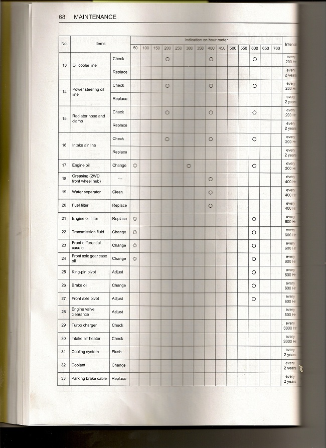

Kubota's maintenance schedule requires Super UDT Hydraulic Transmission Fluid at 50hrs on a new tractor. The dealer does not carry Super UDT. I can get it online for around $106 per 5 gallon pail, and around $40 shipping per pail. It will require about 5 pails or around or around $750 total. Don't the hydraulic filters capture and trap most all of the contaminats. Thought they even had magnets to help. I heard Kubota and other mfgs. merely required a filter change at 50 hours, and then a fluid and filter at the next regular maintenance change. Any thoughts on this? Thanks, luckycanine

Have a Kubota M-108 that I bought late 2011. It holds 17.2 gallons of hydraulic fluid. I would need 4 pails (not 5) of 5 gallons; I stand corrected. Sorry, math is not my forte. Still, a lot of very expensive fluid.
I read the maintenance schedule again and I am supposed to replace both filters and fluids for the engine and transmission, as well as change the fluids for the front differential case, and the front axle gear case at 50 hours. I was hoping your were correct; se la vie.

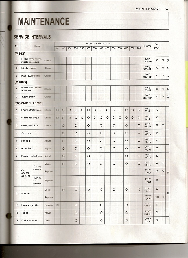

Most of the Kubota's only require a filter change at 50 hours as Boakley stated. However, I'm not sure about the larger Agriculture tractors. Kubota USED to require a full fluid change at 50 but they went away from that, at least on the SCUT's and CUT's. Hopefully some AG owners will chime in. My neighbor recently bought a M7040 and I was present during the delivery heard the dealer rep tell him a fluid change was not necessary until 400 hours. Filters only at 50 hours.

Hi General, will try and post the schedule for the m108...bought latter part of last yr.

Well I'll be...........I wonder if your dealer gave you an old manual leftover? But maybe the larger AG tractors are different from the smaller ones, sure seems that way according to your manual. Maybe send Kubota manufacturing an email asking their input. Hopefully you'll have some more replies tomorrow from some others, but for now I'd follow the manual you got.
You'll get mixed feelings on the whole full fluid change thing. Some do a complete fluid change at 50 and some just follow the manual and do the engine oil and filters. The magnets catch some metal debris but probably not all of it. I do feel your pain on spending all that $$$$ for 17 gallons of hydro fluid.
