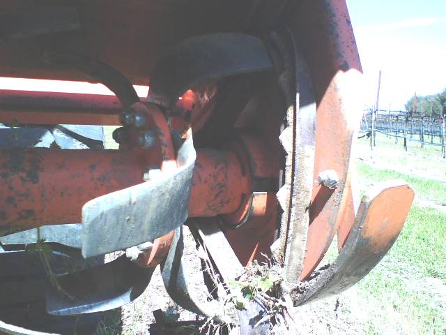

I run CCM 66" behind my CK30 gear and speaking of gear drive vs. chain drive tillers......... was doing a job today when suddenly the tiller stopped cold! couldn't figure what happened, raised it up and looked under and look what I found, an 8' "T" post that had been laying just under the surface of the dirt. It was all bent and wraped around the blades and rotor. Had to unbolt three blades to get out........ no damage any where, not even a bent blade........would a chain drive have stood up to this?

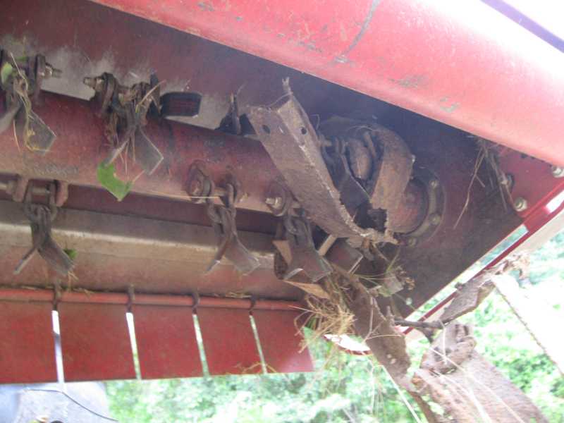

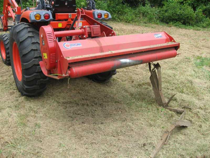

Don't ya just hate it when that happens! I had a similar experience with my flail mower. Mower survived the incident without damage but the half buried angle iron was mangled.
