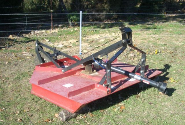

I have no express interest in talking you OUT of buying a rotary cutter. But for the kind of work you describe, those rotary cutters are over-qualified. I'm merely tossing an alternative on the table for you. Otherwise there are quite a few light duty 5' rotary cutters that will do what you describe for half to one third that money. I chop up more serious stuff than that with a five footer I bought at Rural King last summer for $469
But if price is not an object, do you know what a flail mower is/does/can do? Every year I see more and more of them mowing highway right of ways and medians. Trust me, they flail through a lot worse than 1" twigs and frost-heaved rocks. If I didn't have money invested in two rotary cutters and a finish mower already, I could replace all three with one flail mower.
//greg//
