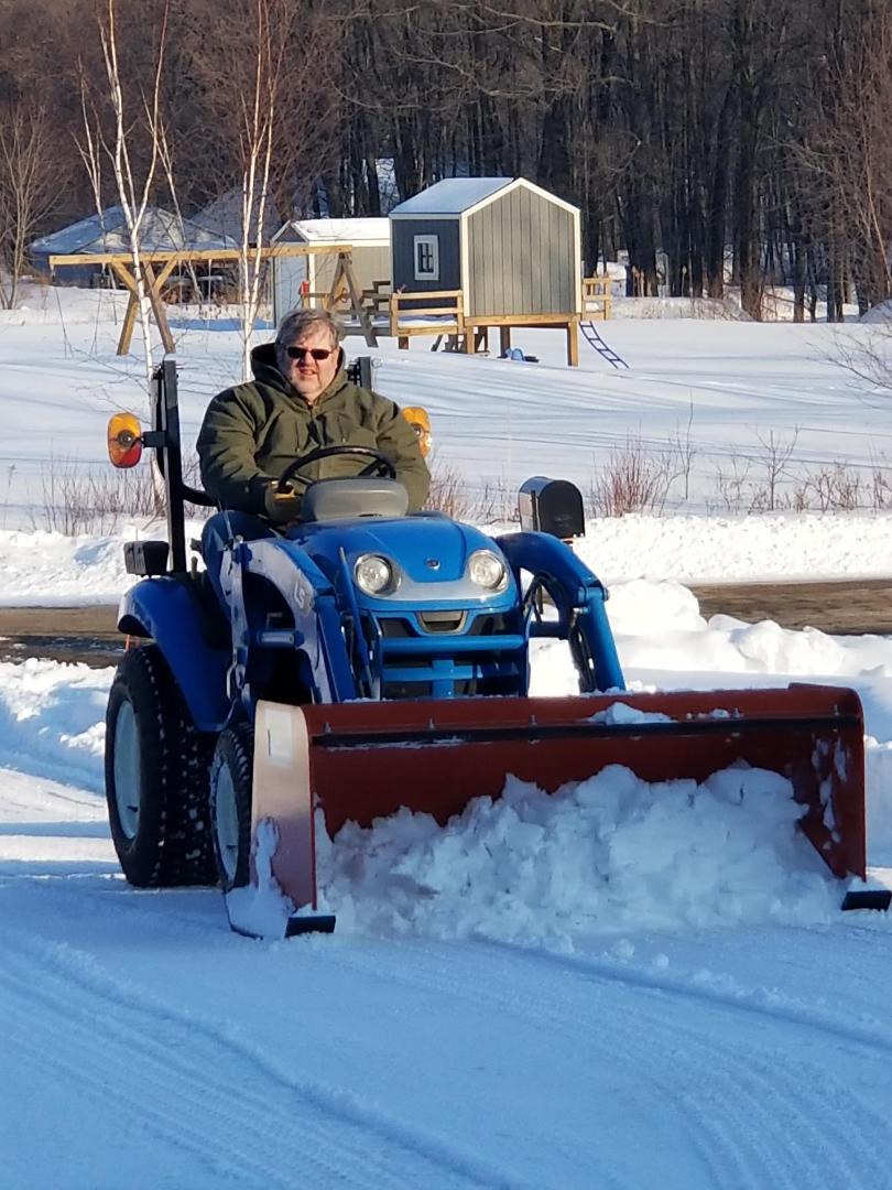

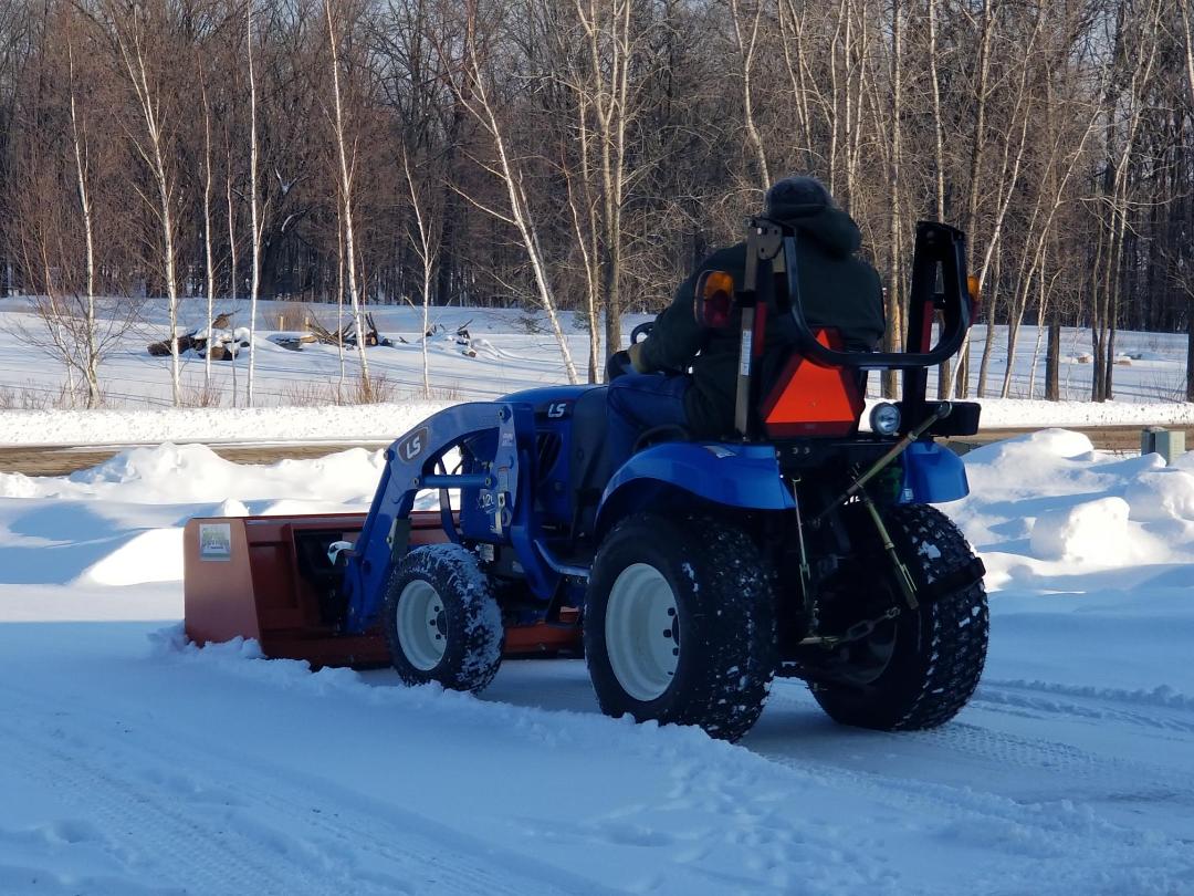

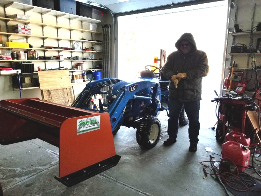

Learning how to use a pusher. Tractor is 4' wide and the pusher is 5' wide with a back blade.

I like the skid shoes on that pusher! Looks like they would be very gravel-friendly. :)
   / 5' Pusher #4
Having the back drag blade is nice as long as your loader can pivot it all the way over.

I would get the deepest/tallest (not widest) pusher as possible. My back drag blade is welded on and adds structural integrity. I still need to plow the overflow afterward - similar to a bucket. I would recommend a blower in the back and a snow bucket in the front if you have lots of snow to address - especially if clearing over a long distance.
My pusher comes highly recommended. Very heavy duty @ 600#. I can't push too far, but works out ok for my paved driveway.
