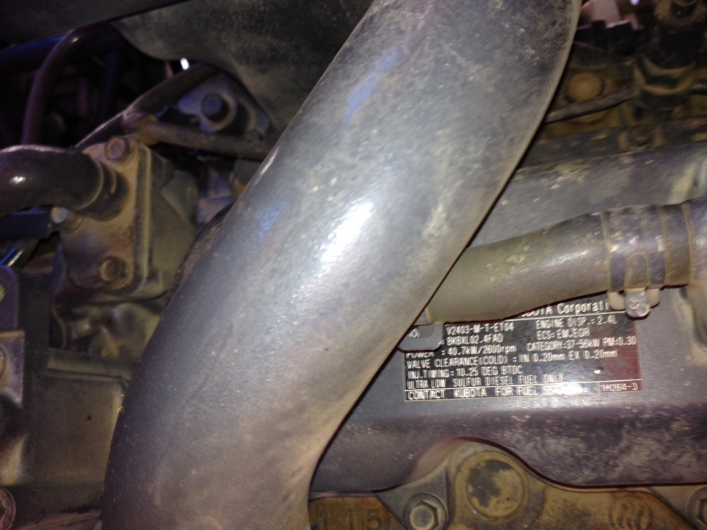

Hopefully the valve adjustment went well for you. I found a picture of the tag on my valve cover, I could see how this would come off over time though with the heat and dirt.

That sticker looks pretty durable and your tractor is at least 10 years younger than mine, maybe they started putting them on later on after mine was built.

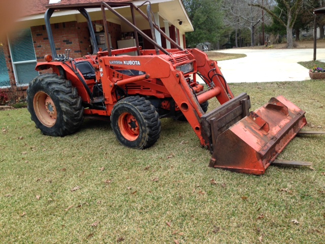

The previous owner had installed an overhead canopy with limb risers and support legs down to the loader bolster. The right leg wouldn't let the loader control valve pass so I had to stop and take it off. I really didn't need it on there anyway. I'll start on the valves tomorrow after I try to get the loader off again.
