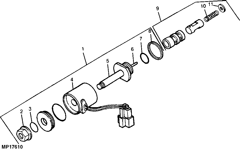

I replaced the PTO solenoid on my 455 trying to correct a no enagage PTO issue. Didn't fix it but had a question about the install. I had to remove the seat pan and lift the fuel tank to be able to get a wrench on the solenoid stem.
When I installed the new stem the gasket marked 8 never touched the tranny case and the armature became tight. I could still move the gasket around. I removed and installed the old armature. Same issue. I pulled out the solenoid valve guts and tried again same results. Verify assembly via diagram. I ended up using two numer 8 gaskets. Not sure what isn't right here.

Sounds like you are in the weeds there friend. I haven't messed with that, nor do I have that model of tractor.
2 gaskets, sure doesn't sound right? I hope you get it figured out

I printed out the solenoid removal and installation pages from the service manual. Going to take it back apart and put back together per those instructions and see if it all goes back together using just one #8 washer as it should be. Service manual says to torque the armature but you need the JDDG757A special socket.
