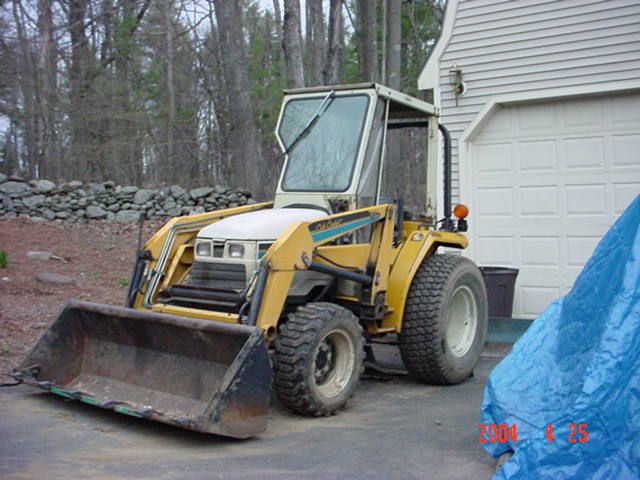

All you need to know is the outside diameter of the tires to find out if you can switch out tires for mix and match. I have these two types on my Cub Cadet with no driveline gear wrap up. I have industrials on the front with turfs on the rear.
