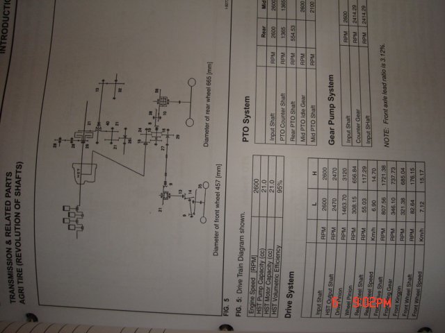

Does anybody have a hard time getting their 2300/2310 out of 4wd. Mine goes in very easy, but to get it out sometimes I have to rock the tractor back and forth.
   / 4wd engagement #2
Between it being mechanical 4wd & the front tire lead ratio, that's normal. Try just backing up a little, or raising the front with the loader, it should come right out.
   / 4wd engagement #3
Both the 4WD, and the diff. lock can at times, require finesse, such as holding your tongue in just the right position, (usually slightly out of the mouth and, to the left or right), to be able to engage and or disengage them. This is normal.
   / 4wd engagement #4
Yep normal. Often I have to go forward or backward a a little or turn the wheel at the same time to get it to disengage. I'd rather have it engage easily and disengage the way it does than the other way around. As well, the rear diff lock sometimes takes a little moving around before it releases. Just have to release all the tension and binding in the drivetrain.

Try accelerating and then disengage just as you let off the throttle. Works real well on my Mahindra.

Make sure that you are on gravel, dirt or lawn when shifting out of 4wd. Tractor has a front axle lead ratio. If you are on concrete or asphalt and the tractor is in 4wd the tires can't "slip" causing the the drive train to be lightly under load making it harder to shift out of 4wd.

Curious, it's not clear to me what you mean with "front axle lead ratio". What does that mean?

I was told the axle ratio on the front axle is 1% faster on the 2300's than the rear axle ratio so that the front will turn better (in 4WD) than if they were both the same.

DEWFPO nailed it, except for the ratio (3.12%)-- see photo of svc manual spec sheet :)
