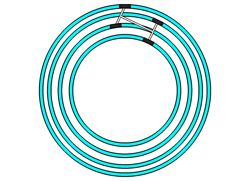

Any advice on when or when NOT to engage the 4WD on my 2320 (other than on pavement)?
Just curious from experience if theres something I shouldn't be doing that would be hard on the tractor?
Thanks-:thumbsup:
   / 4WD Advice? #2
Use it ONLY on slippery surfaces. The fronts actually turn faster that the rears and if there is no "slippage" then you can damage the drivetrain especially when turning.
Here is a good picture to ponder:
Just when I think I have seen it all from you.:laughing:
Good advice though. Just as on a truck. Use it when you need it.
