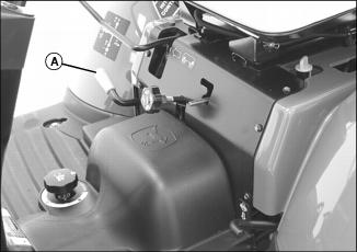

I bought a used 2009 jd 2305 and am not sure it is fully in 4wd. What exactly do you have to do to put it in 4wd?

This is from the 2305 Manual:
Using Mechanical Front Wheel Drive (MFWD)
NOTE: Label on dash illustrates MFWD operation.
Mechanical front wheel drive (MFWD) enables the powertrain to drive both front and rear axles for improved traction on difficult ground conditions and provides 4-wheel braking. MFWD can be engaged and disengaged on-the-go with light loads and on low traction surfaces.
c CAUTION: Avoid injury! Use extra caution when driving on slopes. To increase traction and provide four-wheel braking, engage mechanical front wheel drive (MFWD) when driving on slopes. Be aware that MFWD can improve access to dangerously sloped terrain, thereby increasing the possibility of tipover.
To improve braking on sloped, icy, wet, or graveled surfaces, engage the MFWD. Add ballast to the tractor and travel at a reduced speed to avoid skidding and loss of steering control.
IMPORTANT: Avoid damage! Always disengage MFWD when driving on a paved surface.
Put the transmission levers in neutral to move the machine when the engine is not running.
NOTE: It may be necessary to reduce engine load to disengage front wheel drive.
IMPORTANT: Avoid damage! Hand engage MFWD lever only. Foot engagement can damage mechanism.
Push down on MFWD lever (A) to engage MFWD. Pull up on lever to disengage MFWD.
See attached picture for location of (A)
