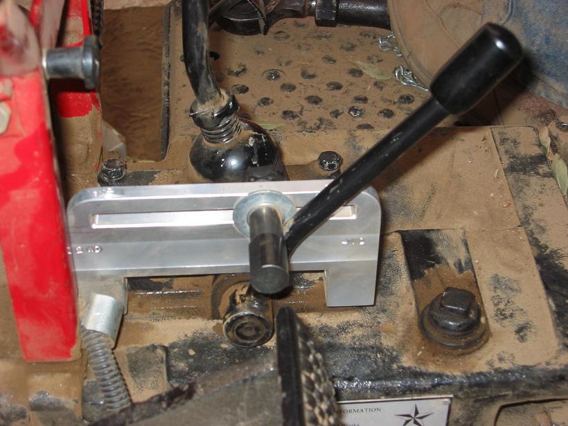

My KAMA 554 slips out of 4WD occasionally. The 4WD works great and the gears mesh just fine, but I was told there is a detent to keep the lever in either 2WD or 4WD. I could not find the adjustment, so I machined a bracket that bolts on top of the transmission.
It has a sliding adjustment bar that can be tightened to keep the lever in either 2WD or 4WD and works great. I have had no problem with the tractor coming out of gear since.

Highbeam,
This way I can change it form 4WD to 2WD with a twist of a knob. Glad you like it.

Boy that really is a nice piece of work. Did you machine the part from a solid block of AL? How did you do the raised letters?

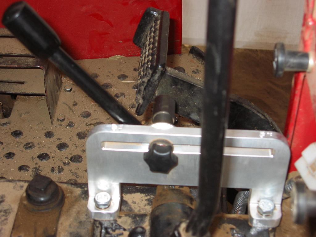

Thanks for the compliment. The raised letter just turned out that way when I stamped them in. That unit is machined from a solid (billet) piece of Aluminum 60-61 T6 grade. Had a bunch of it lying around I used for fixtures for my other machine projects and turned that piece into something useful. Here's a picture of the other side showing the adjustment knob that slides forward or backward.

Rob,
I see you are a machinist. On my transmission there is a shaft with three detent notches milled with the side of an end mill. A spring loaded ball bearing drops in the notches to provide the three slider positions. Kubota instructed the dealer to send this shaft to a local machine shop and have the detents milled 0.010" deeper. This may have been the main problem. Hope this helps or gives you ideas,
   / 4WD/2WD Lever Slips Out
</font><font color="blue" class="small">( On my transmission there is a shaft with three detent notches ...Kubota instructed the dealer to send this shaft to a local machine shop and have the detents milled 0.010" deeper.)</font>
It could be the problem. The spring loaded plungers and detents should be set up according to the load imposed. There are charts for setting up this relationship and there are various spring rates too. Or, the plunger may have backed out from it's original position? The plungers are usually secured with a ny-lock insert, but I try to use a lock nut or screw instead.
