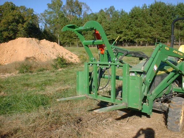

Here the grapple I bought off of ebay fom a seller named Andy Tatro, username HTATRO. A few people here on TBN have bought from him. The quality of his grapple is great. Just from looking at the Dehnerwelding website, their's appear to use thinner metal and their grapple doesn't have teeth. Andy's grapple was $340 delivered. If you do a search here on TBN you should be able to see more of Andy's work.
Here is his e-mail address.
htatro@bwsys.net

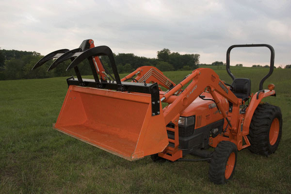

I've been looking at the same issue but have focused on which grapple attachment. The 4 in 1 is really more of a construction tool than a brush clean up device which is what my main need is. The 4 in 1 really doesn't pick up nearly as much debris in one bite than a grapple attachment would.
My research so far has discovered the two you posted on (ATI and Dehnerwelding) as well as the Add A Grapple (precision manufacturing) and another ebay (The Thumb=Andy Tatro) version. The Dehner product looks nice and is easily the least expensive. Joey is a very responsive guy and I would not hesitate to use that if it met my needs. I unfortunately have a bucket hook welded right in the middle of my top bucket lip where that type of grapple attachment would need to be bolted so I cannot use that style (goes for the Thumb too). The ATI is a very nice unit but very expensive compared to the almost identical Add A Grapple (see photo). About twice the cost because you can only get it through dealers. Also, the ATI unit requires that you do both bolting and welding as part of installation while the Add A Grapple is just bolting. I'm not certain but it looks like the Add A Grapple comes off a bit more easily too.
That is the state of my research at this point. I am also looking at some light duty root grapples that would switch out with the bucket. These are clearly more expensive than the bucket attachments but have some added advantages in how easy it is to pick up brush and in how much you can bite.
