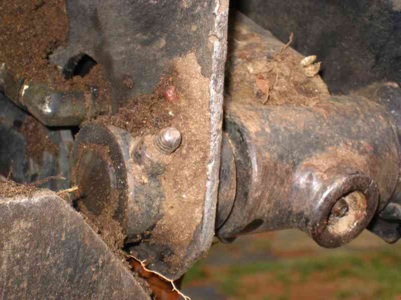

I have the HJ2-60 from WR Long. Nice bucket. Do be careful with the grease zerks. Some of them are vulnerable to being packed with dirt. I haven't worked out a zerk cap system yet but it seems a good thing to do.

Well the price is certainly right on the zerk caps. I think they may get knocked off but if the retainer/protector ring around the zerk gets filled up with dirt before the zerk cap got knocked off it would work fine. Worth a try.
   / 4N1 Bucket, Top-N-Tilt, Remote Joy Stick #10
Yea,
I had a lawnmower come from the factory with the caps. Seemed to hold up well. I've been meaning to order a bunch to put on the disc, loader, etc...
The ones that were on my lawnmower were real tight and held on pretty well.
