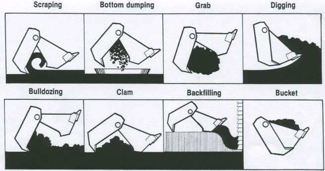

I hope you enjoy the 4n1. You can a little more comfort in knowing that Mr. Long at the mfg. is a real fine fellow that's always happy to help a user. They are a small family business in Tarboro NC.
If you didn't get a tootbar bar or teeth with the bucket .. you may want to give yourself one... On a B2710 , it will really help the tractor load the bucket more and faster.
Let us know when you get the "back dragging with the two edges" skill mastered. That's when you will really love the 4n1.
