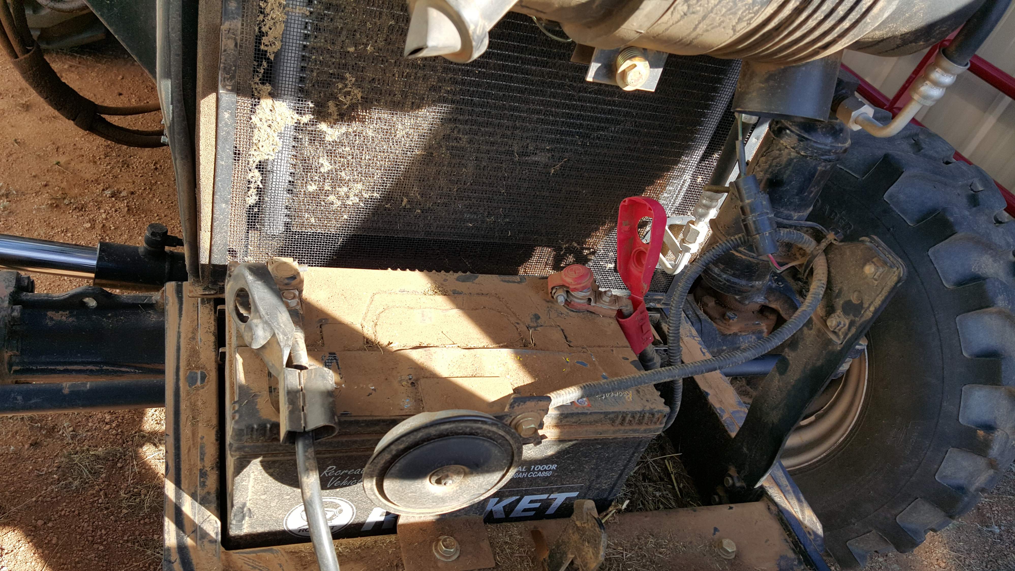

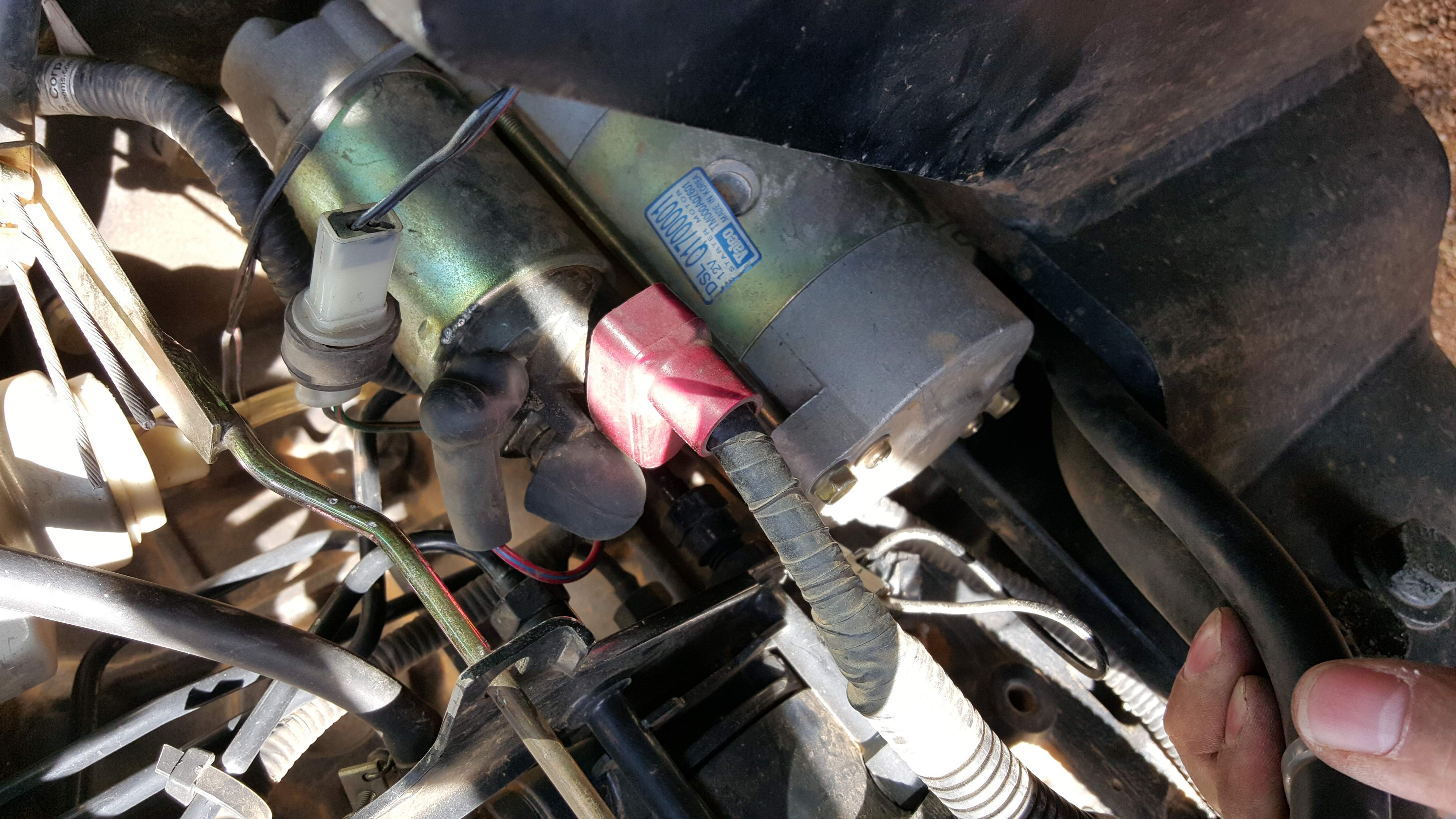

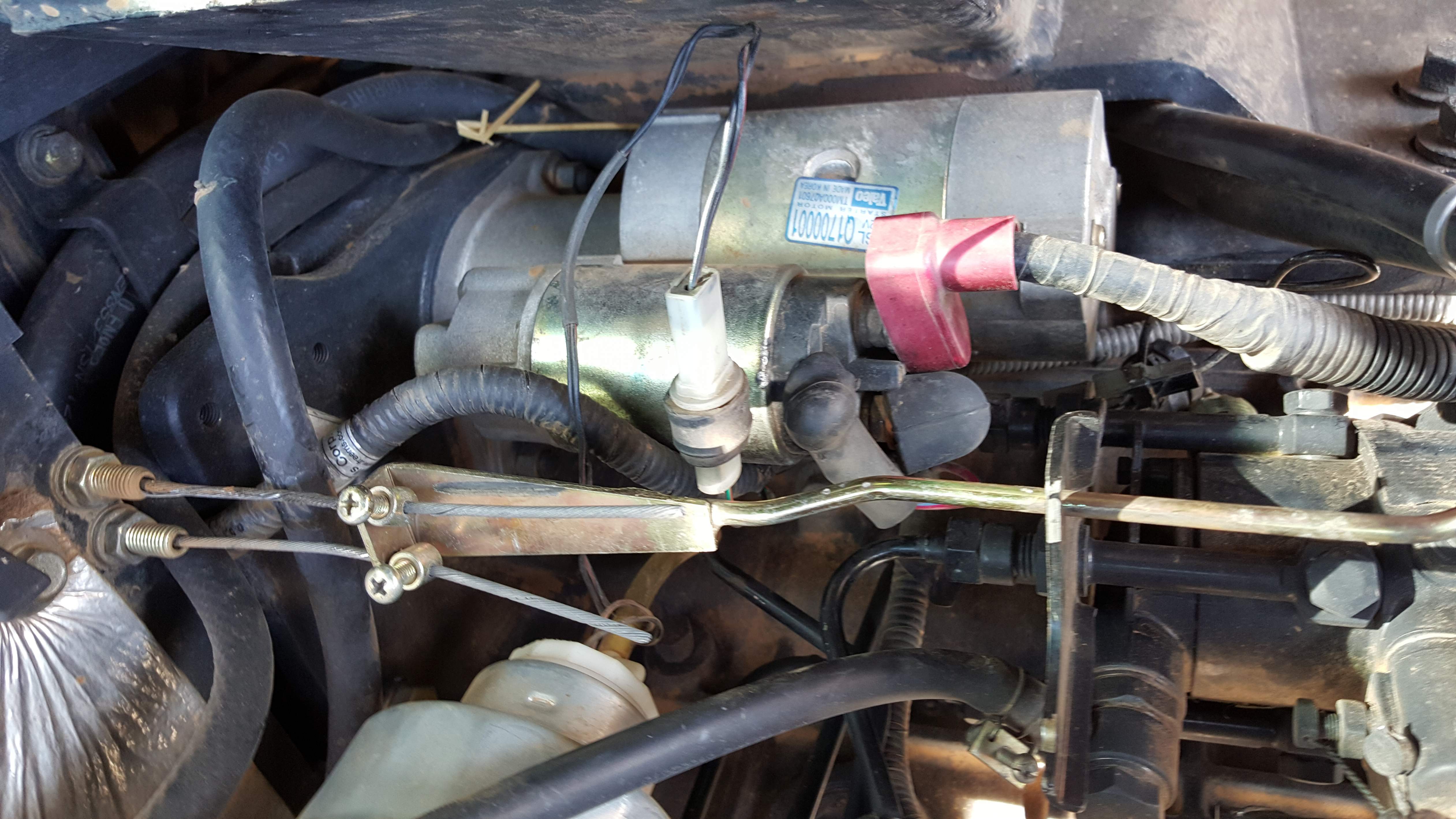

The fusible link may look just like an electrical connector.
Post a picture of the wiring around the battery and starter.
Dave M7040
   / 4940c Wont Start - Electrical?
I don't see any wires that look bad or even look like a fusible linknow to me, but maybe it's different on tractors? All the wires and fuses test good for continuity. I must be missing something! The loader makes it hard for me to really crawl up in there so I can see behind the starter...
