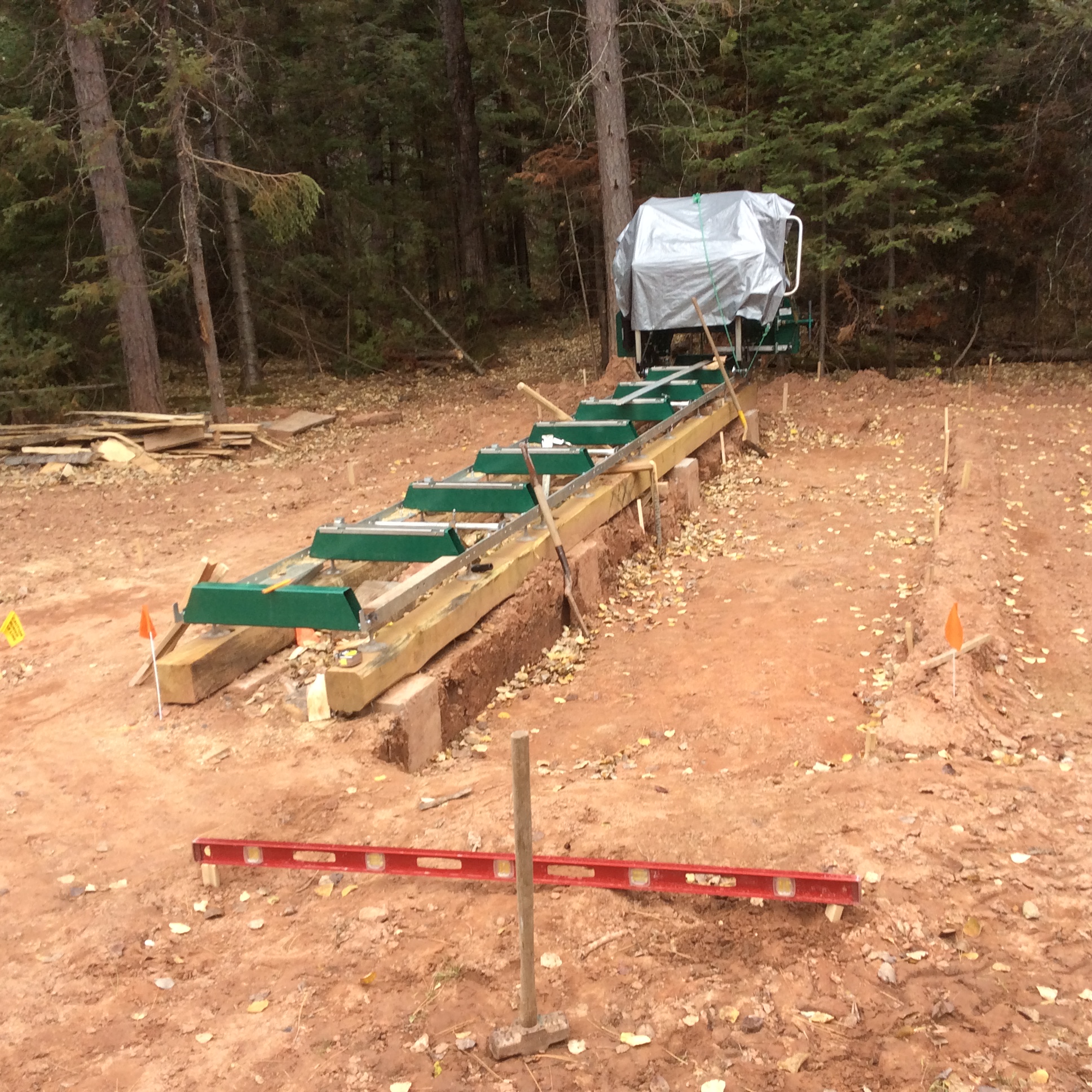

If you are using a concrete crew, ask if they have a "concrete buggy." Or check and see if any of the local rental places have one available. Might be cheaper than a pump if you can find one...?

OP - You've got me wondering on why you don't have a wide easy path to the mill. Are you planning on pulling boards out on a narrow trailer?
Some ready mix places also rent READY MIX DUMP TRAILERs. The link rents it free if you buy ready mix. If you've got a good path to the mill your tractor might be able to pull it for 7 or 8 trips. It would probably weigh a little less than 3 tons full.

You're right . I will run out of time because I still have to excavate the site on the the other side of the mill ( left side in photo ).Right side pretty much prepped Very poor soil ---> will need a layer of "heavies" and then some class 5. Then some rebar followed by the 5" of concrete. So I'm looking at a Spring pour when the Northern Wis weather moderates.

Get everything prepped now, before winter, (except re-bar), and then you will not need to disturb the soil that has settled nicely over the winter.

Looks to me like the cart is ahead of the horse. Why didn’t you excavate the site, pour the pad and set the mill up on the pad? Your mill is going to sit on “poor soil” and the rails won’t be straight by spring. I think I’d cut bait and start over.

My mill is on a concrete pad.

Please refer to the photo of my mill. If you look closely you will see eight concrete piers that are set 5 1/2' below grade.
