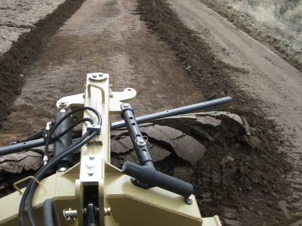

I have a 150 yards of gravel drive to maintain. I've been debating between a GS1560 and a GS1548. Tractor is 22.5 HP at engine, 1367 lbs. I will have the loader on, so I can add weight easily for extra traction.
Based on what I've read, the 48" is the preferred size for this tractor. Is it easy to crown a driveway that is 10' wide with a 4' wide land plane? I haven't found an answer to this yet.
I feel like the 60" might be easier to maintain a crown. Would it be possible to manage the traction/HP issues by adjusting the cutting depth of the blade? Or is the full box of material just too much for this tractor to pull?
I do have a small hill in my back yard that worries me a bit, making me think the 48" is the right path. But I worry about the crown.

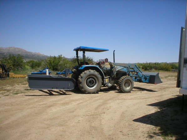

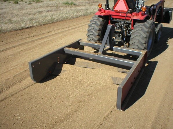

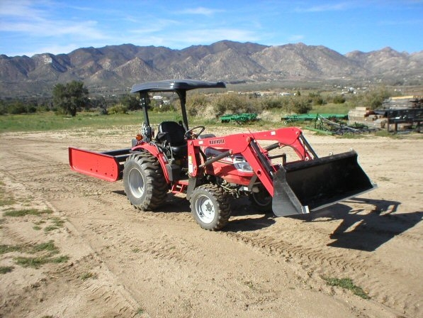

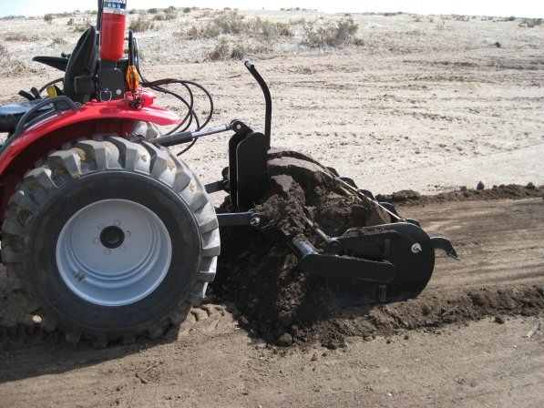

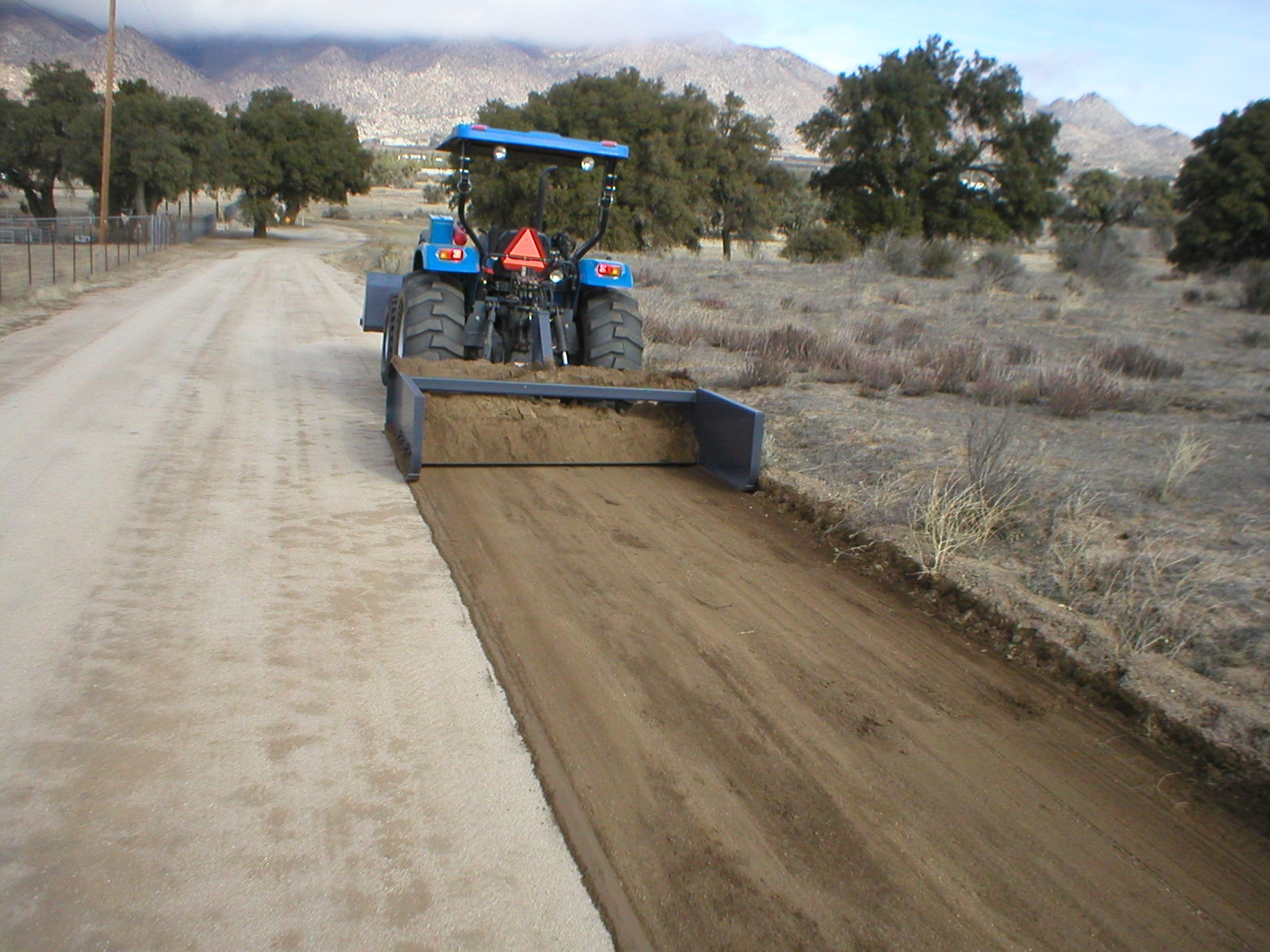

You really are not going to build a crown with any land plane that I know of. Even though the blades are typically angled, they simply do not move the material sideways much at all.
I have tested the side movement of material on my Land planes, (I have 5' & 7' units) by painting the ground and watching-measuring just how much the ground moved sideways. About 1" was all it moved.
So thinking that you are going to actually build a crown is wishful thinking.
Get the 48" unit, it will do a nice job of maintaining the drive.

Based on your comments, I am guessing you would get the 48" unit, and just grade the drive flat. Thank you.
I had the impression you could crown the road by adjusting the blades to cut deeper on the right side of the unit (looking from behind)? Is that not effective either?
   / 48 or 60" Grading Scraper/Land Plane for GC2300? Can both crown the driveway? #5

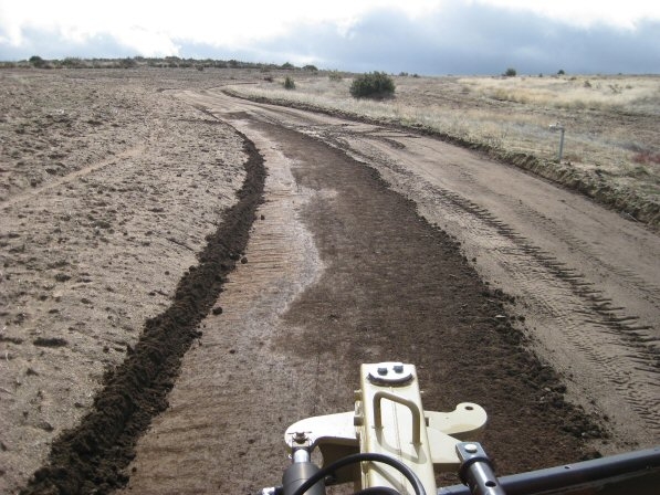

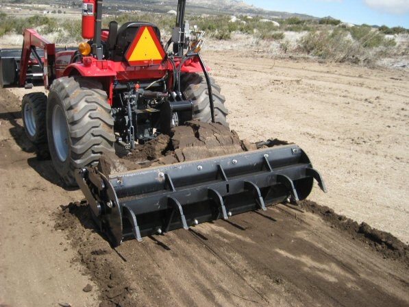

Not really, you just dig the material unevenly, it still only flows over the blade. It does not in reality move side-side, it still only flows basically straight over the blade.
You want to crown the road, you need a rear blade, and in your case, your tractor is really too light to be rolling material to the center to easily crown a road.
If the road surface is softer, then a lighter blade can do it.
It's not that your tractor can't do it, but you need the right implements and the time to do it.
And yes practice usually makes a person better at what they are doing.
Good luck and don't give up, I started out grading driveways with a Sears SS12 garden tractor with a 36" roll over Gannon. 65" ROBB pictured behind a 32hp tractor.

Thank you. I didn't realize a land plane wasn't very useful for building a crown......now I'm wondering if it is useful for maintaining an already crowned road? I have a rear blade and I have pulled my road into a crown with it before. I'm wondering now if I can use a 48" land plane for maintenance (several times a year), and every 2 or 3 years use the back blade to re-establish a crown to the road.
   / 48 or 60" Grading Scraper/Land Plane for GC2300? Can both crown the driveway? #8
It would be hard to beat a land plane for general maintenance. I have well over a mile of drive to maintain and when I got my land plane, the time spent for general maintenance was cut by more than half. Yes you can keep the crown, it's just not practical to expect to build a crown though. Again, the material basically just flows over the blades and does not really transfer all that much from side-side.
Get the land plane, you will not regret it. (y)(y)
