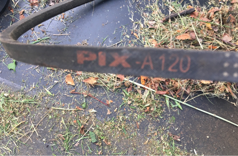

Well I finally got my tractor up and running after the main pump failure. My grass was so tall and I was pushing it hard and belt came off so I took a picture of it with the size on it. It's still the factory belt for my 60" deck.

Amazon has most of these belts, just search for your number. Odd, this post is titled for 48" belt, but the pic shown is for an A-120 with is a 1/2"by 122" belt, right?

Yes, he was just showing his 60" deck belt for another 60" deck owner that questioned that belt.
