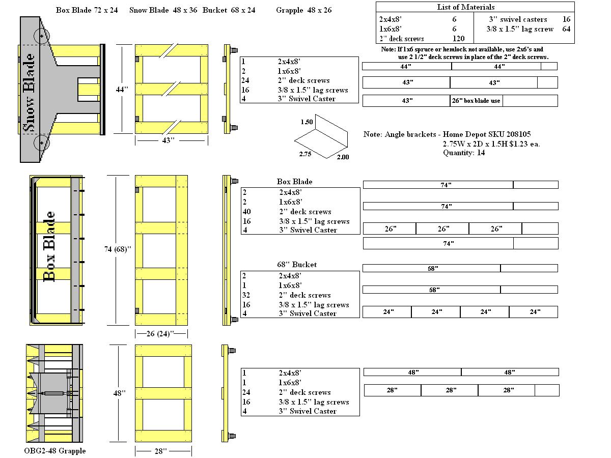

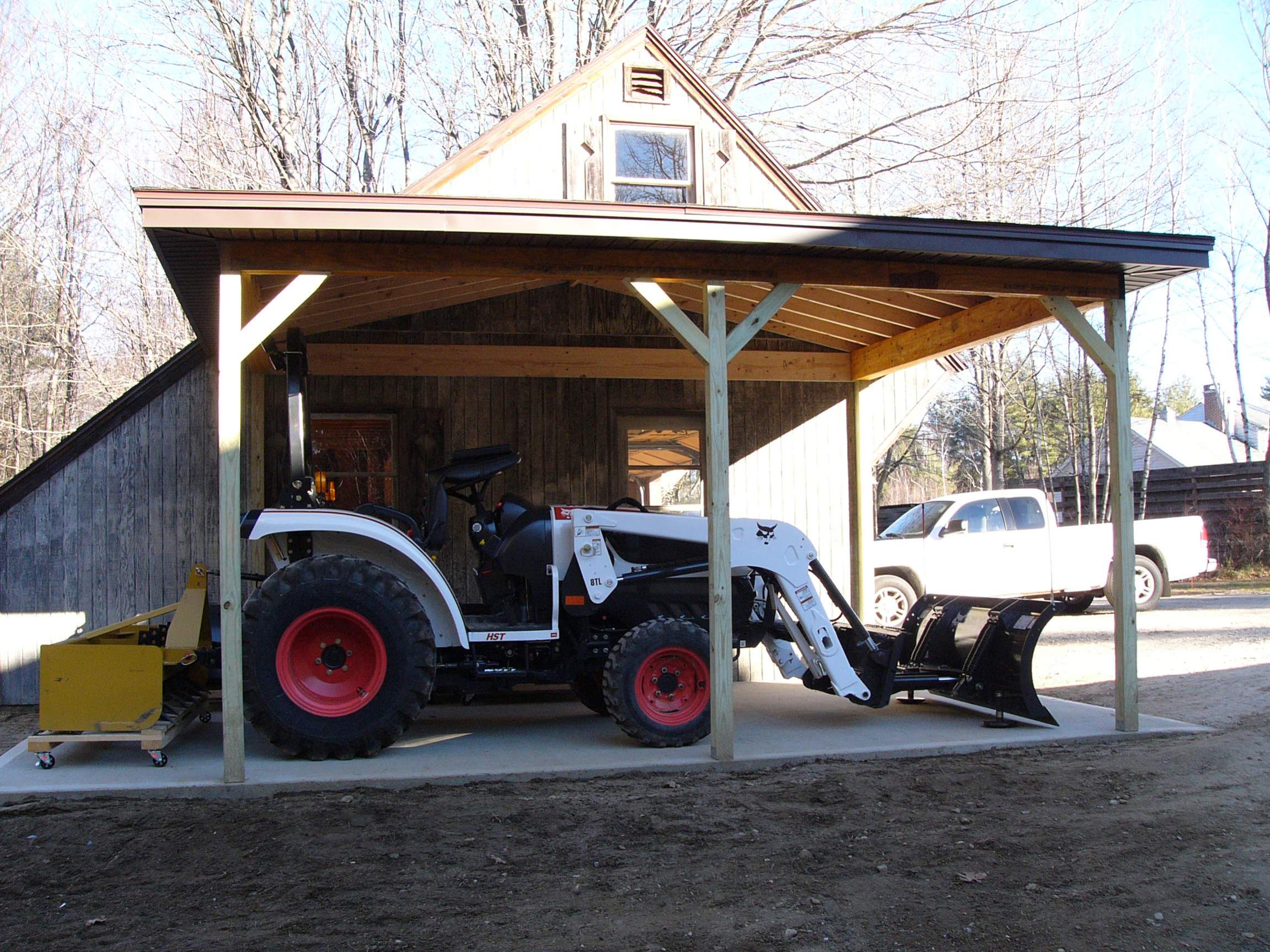

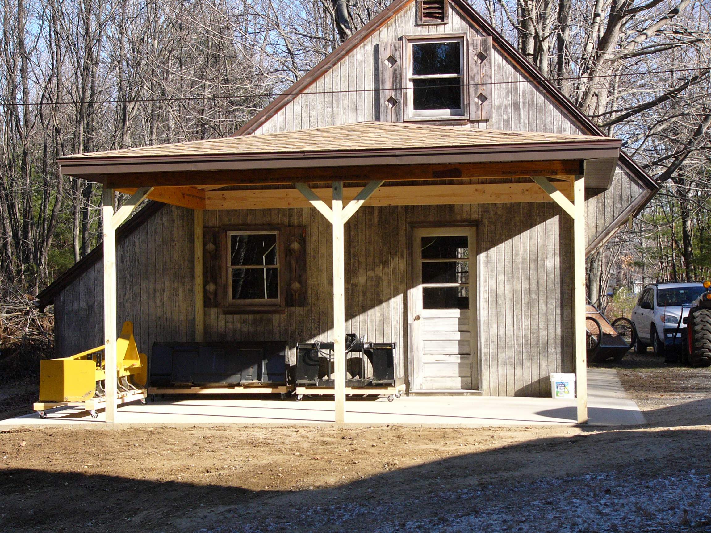

Here is a set of sketches for a series of dollys that I made for some of my attachments.
The lumber was rough cut hemlock 2x4s and 1x6s. The 3" metal casters were purchased
from a local outlet, R&R Public Wholesale in Hooksett, NH. for $4.50 ea.
Shown below are photos of the actual dollys in use.
