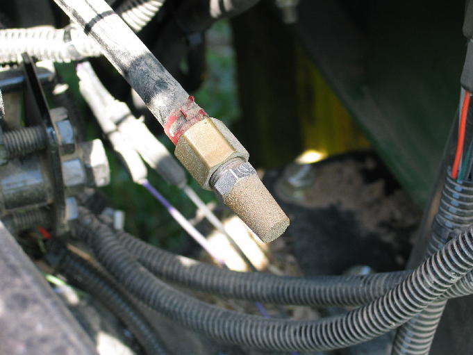

I was using my landscape rake to pull limbs out of an area I had just cleared, and got a limb jambed up under the tractor. Crawled under to get it out, and found this (see attachment). This is on the left side of the tractor between the hydro filters and the rear axle. No fluid was coming out, and I only had a little more to do, so I did it and went home. This morning, I inspected some more. The threads aren't damaged, nor can I find anywhere that it belongs.
More pictures on next few posts.

So I chased the hose this morning, and found this on the other end. Looks like some sort of air filter?

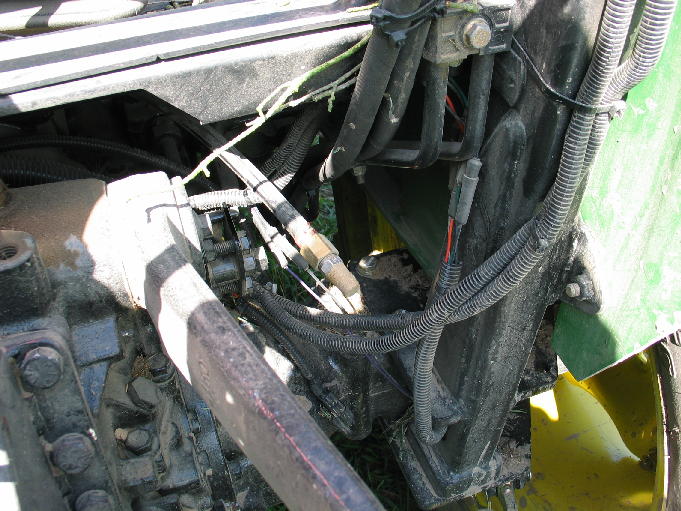

So I'm worried that this is an air intake for the hydro transmission or something like that. Don't want to use the tractor until I know. This is a picture of the area of the filter end. It is tugged out a little.

So I would appreciate any help I can get. I looked on JD Parts to try and find a name for it with no luck. So if there is anybody out there with a 4710 or like model, I would appreciate it if you could look and find out where this goes, or if it does go anywhere. I'm on idle until I can find out. Considered pulling the operators station to get a better view, but that's a little extreme at the point. Hopefully this site will answer my questions. Any and all help appreciated.

It looks like a breather for the transmission to relieve the pressure build up. But I have never seen one that wasn't just screwed into the transmission housing with a metal cover.

That looks like the vent hose that is supposed to hook up to the MFWD actuator. It's on the left side of the trans housing just in front of the axle, at least it is on my power reverser. The actuator looks like a small hydraulic cylinder (it is) about a foot long or so. It will have a line hooked up on one end of the cylinder, and the breather goes on the other end. You probably want to clean everything up really good before putting it back together.

Figured it out after three trips to the tractor (15 miles one way from my house) and some shopping around town. It was a breather tube for a small hydraulic cylinder. As Jay said, it may be the MFWD actuator. I sheared off the barb fitting that connected the cylinder to the breather tube. After I figured that out, I pulled off the cylinder and took it into my local JD dealer. The pulled the leftover threaded part of the fitting out for me, but of course didn't have a replacement. They could order it - but that would put me out of commission until next week. Soooo, long story short, did a bunch of shopping and finally found what I needed. So I'm all back together and running fine. Now I need to look into some underbody protection to protect against stuff like this.
