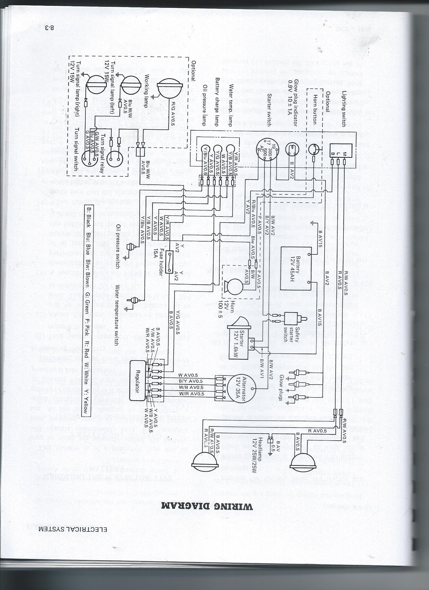

Hey guys can anybody tell me how the stater switch is wired on a 470 Buck?
   / 470D buck starter problem #2
I will try to scan a diagram for you.
Thanks. I think the switch may be bad, because the wiring seems pretty simple. However, I want to make sure before ordering a $50 switch.
   / 470D buck starter problem #4
They used to be around $90.00!!
   / 470D buck starter problem #5
Sorry this took so long.
The starter had a dead spot in it. Had it rebuild for 100 bucks. Now just need to reinstall it. Thanks
