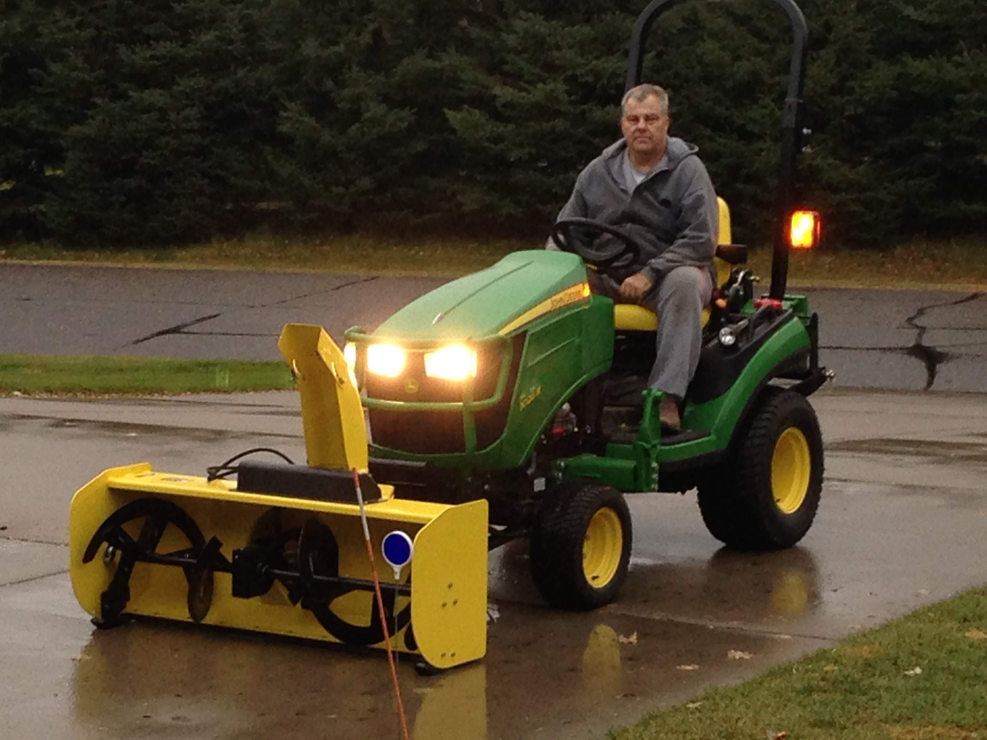

The JD SCUT/CUT tractors need 2 double u-joints to form a 'V' under the front MFWD axle, so the drive shaft to the blower is different than that used for the JD L&G tractors ('X' series). I know, because I used to have a JD L&G tractor with the 47" blower. I upgraded to JD 1026R with the 54" blower.
If you have a fair size area to remove snow from, the 54" is the only way to go. It saves time & the SCUT/CUT engine has ample torque to blast snow out of it. I love mine.
Good luck............
Not sure where you got that from. My 4115 uses a drive shaft for the front pro that has one u joint. There are two carrier bearings in the front bracket vs one for the heavy duty garden tractors. I have owned a few 445's, and one with the front mount snow blower. The drive shaft for them is different, but still only one u joint.
Got it from my Deere dealer. The drive shaft has to make a 'V' bend under the front axle to get to the snowblower drive shaft. So it has 2 double u-joints. It is pretty funky.
If I remember (ha!) I'll take a photo & post it.
The 4115 is likely high enough off the ground that the front drive PTO shaft can go straight out the front. The 445 actually had a hole (!) in the front solid cast iron axle for the front PTO drive shaft to go through. I remember it well.
Yep, the 445 has the hole in the front axle.
The OP was asking about a blower for his 2520 though, and it is the direct replacement for the 4115. Same exact frame, front and rear axles, everything except for a few added cc's for the engine and a few more lbs lift on the 3pt hitch. His front drive shaft should be like mine I would have to believe (unless they changed them for some reason that I am unaware of).

Ah - thanks, RG1. Then X575 should fit 2520, as long as 2520 has the front bracket kit. Front PTO drive shaft should go straight out front.
