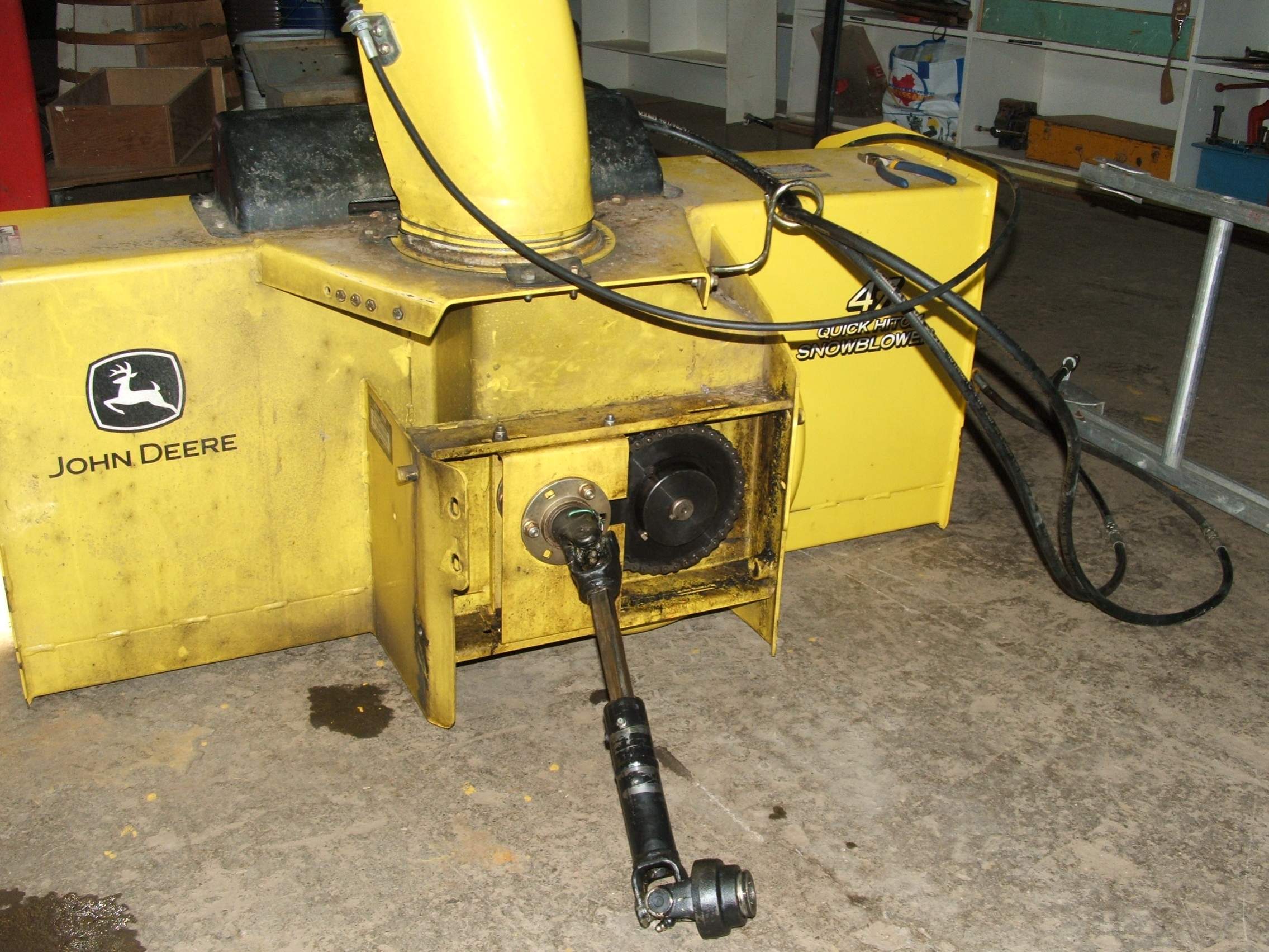

I recently purchased a new drive shaft for my 47 in blower. Old one was damaged. Removed the old one easily by removing the retaining pin and sliding the drive shaft off the shaft which exists from the bower.
I placed the new drive shaft onto the shaft coming out of the blower aligning the woodruff key as per the manual.
BUT when I attempt to re-insert the retaining pin it appears the holes done not line up. The holes on the shaft which exits the blower appear to be further in (closer to blower) than the holes on the drive shaft. The drive shaft is pushed as far onto the shaft from the blower as it can go.
This seems like it should be easy per the manual. But it is proving to be a pain. Has anyone else done this installation? What could I be missing?
The shaft from the blower does not appear to have any play. I tried to re-install the old drive shaft and am having the same issue.
Will try to call the dealer next week, but my guess is they will say 'bring it in". At a $100 per hour, I would prefer to try to fix this myself.
ANy help is appreciated.
Thanks
John

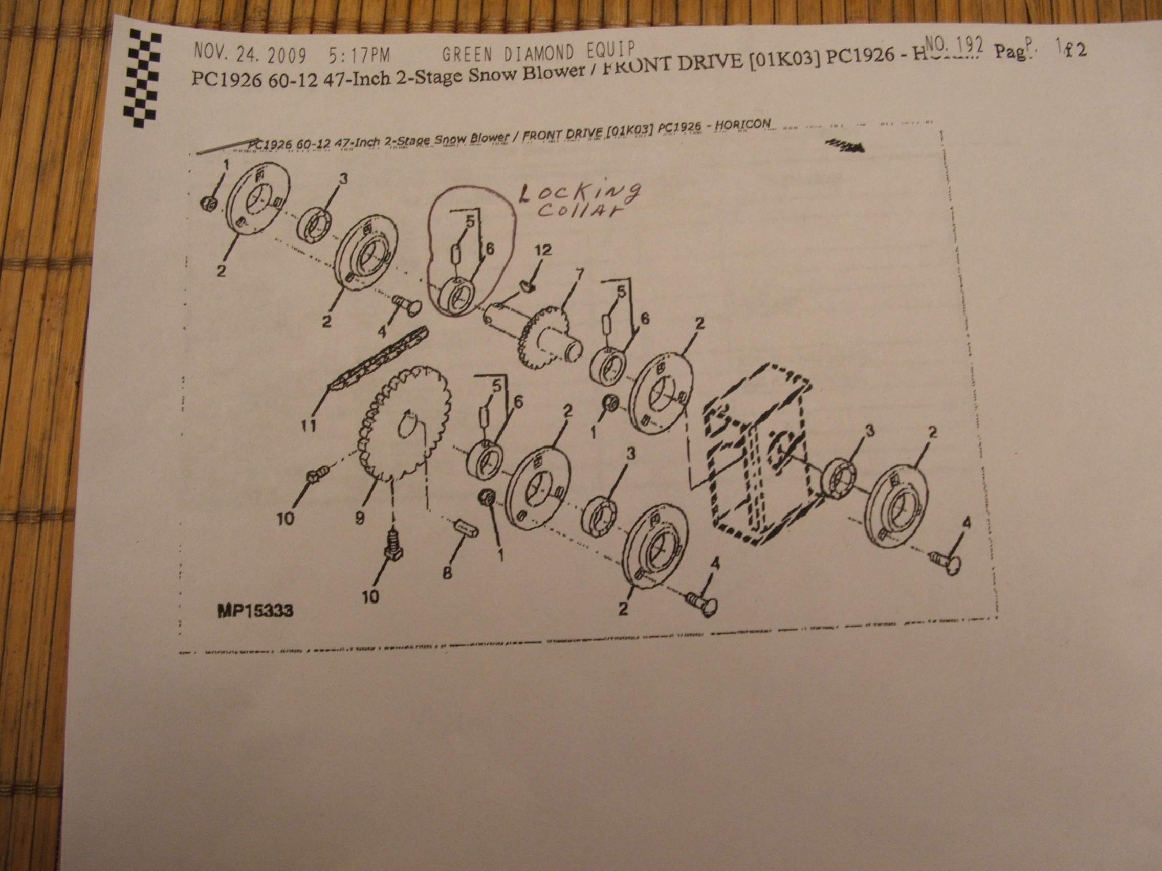

What is listed as parts 7 & 12 in the pix stick out the back of the blower housing. THe shaft (7) has a set of holes drilled in it . The drive shaft that is external to the blower and connects to the front PTO on my tractor slides onto 7 using the woodruff key (12) as a guide. It to has a set of holes. A rolled pin is inserted through the holes to hold the drive shaft onto 7.
What is occurring is the holes in 7 don't line up with the holes in the external drive shaft.
It appears that 7 needs to stick out of the blower housing further.

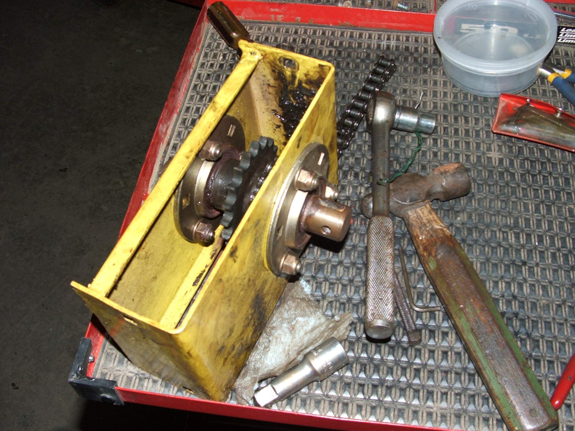

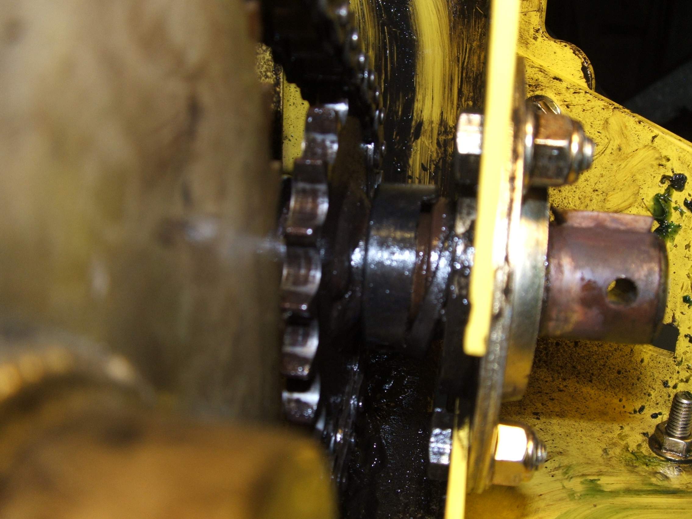

Take a look at these pics, can you see anything different from your set-up. Ignore the broken lock collar in the first pic.

Yes, the shaft coming out on the right in pix #2 is what appears to be too far in (close to the tractor). It is on to this shaft that the PTO/drive shaft is slid (as I am sure you know).
I thought about using a punch to pull that shaft forward while I tap in the pin, but I did not want to damage the blower.

Are spacers #6 and roll pins(#5) in place? Are the spacers possibly reversed? Or are they the same size? Just grasping at straws, here. I had mine apart last year, but didn't run into any problems. Didn't change any parts, tho.
   / 47" Snowblower Driveshaft Replacement #9
When the collar broke it allowed the shaft to slide through the bearing. That,s why it appears short.
   / 47" Snowblower Driveshaft Replacement #10
#6 and #5 are not spacers or roll pin, it is a lock collar and a set screw. When I replace the lock collar I had to take everything apart. Had no problem putting it back together. Have you measure the old shaft with the new one to see if they were the same length?
