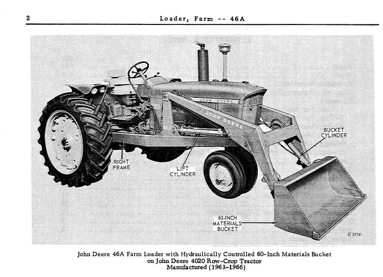

I have a John Deere 3010 Diesel Loader and I am looking at purchasing a 46A loader. The 46A loader doesn't have a bucket however. My question is how universal are these bukets? Will I need to find another john deere bucket or will I likely have more flexibility?
   / 46A Loader #2
Looks like my 47 JD loader. I think this is not universal but a simple welder could fab something up easy. I bought an old Massey bucket for mine and got a welder to alter it to fit. Works fine so far - just had no choice. Otherwise if you need a new one there are shops that will weld one up with proper brackets.
   / 46A Loader #3

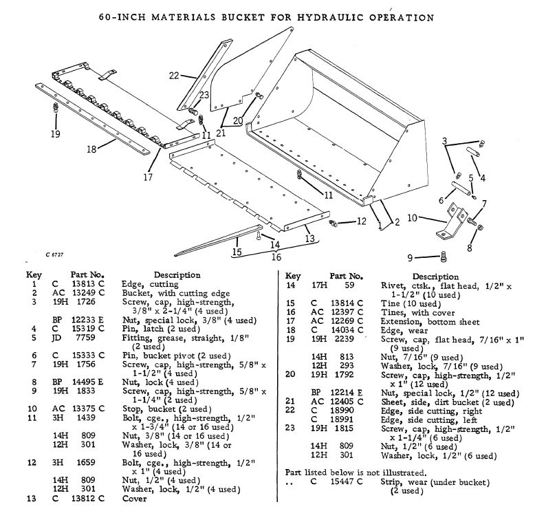

I performed a search on JDparts.com and the 60" bucket(AC13249) for a 46A isn't listed to fit later model FEL's. I do think a good welder(fabricator) can make any bucket fit a 46A
