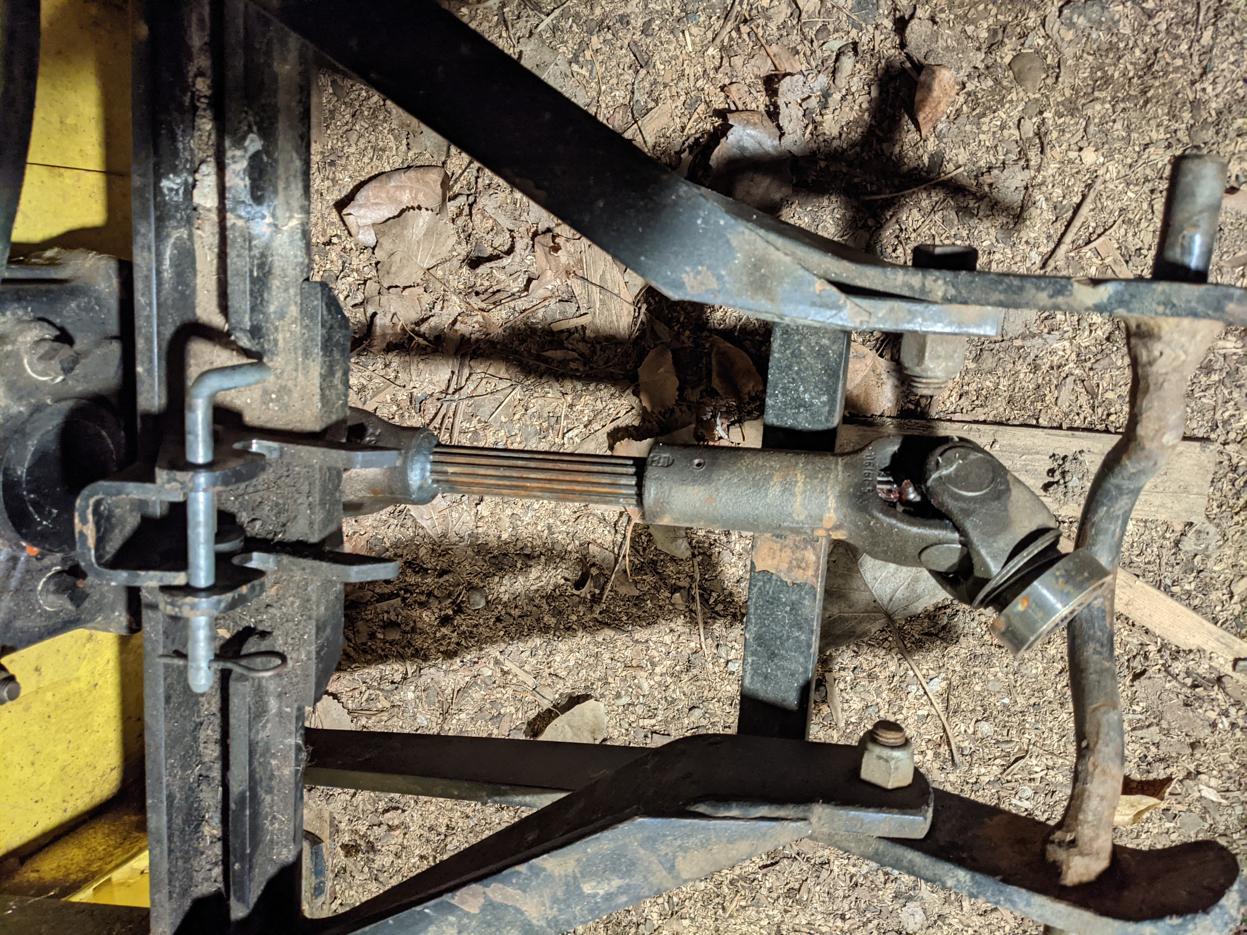

Just got a used 46 snow thrower and it didn't have the short driveshaft. Does anyone know if the shaft off a broom or the shaft off a 60 inch deck would work as a substitute? Or is there someware i can go to get one for cheap? Going to check with the used parts guys around here but don't want to drive 3 hours if i can help it.

I went to a machine shop and told the owner what I wanted. He pieced it all together out of his parts catalogue and ordered the parts. I took it all home and cut the splined part to length and I had a driveshaft. It was about $300 CAD. There was no welding involved.
You can just notice the end of the splined shaft beside the u-joint. That was the end I needed to cut off to make the shaft the correct length. It doesn't look exactly like the John Deere shaft but it works and was considerably cheaper
You could also check with Surplus Supply to see if they have a surplus shaft that would work. Also a pto and driveline shop would be able to set you up with the parts you need.

I don't know for sure the length but could I just use the one off the mower deck? Not a lot of grass to mow in the winter sooo...

And I wasn't able to find anyone who has just the shaft used around here. The problem with going to the store is its an hour drive there and I am not sure Exactly what i need without having the tractor with me. might just drag it down there but don't want to. That's the main reason I am wondering about the deck shaft. Can just swap it at the end of the year and I wont lose it.

If you look in jd parts, the yoke that slides onto the PTO stub from the tranny to your mower deck is the same part # as the yoke that connects to the long PTO shaft to the short PTO shaft for the snow thrower.. (M131889). So that end looks like it would work.
But the other end of the short shaft doesn't look like it will fit the two different gear boxes (mower deck and snow thrower).
https://partscatalog.deere.com/jdrc/sidebyside/equipment/82667/referrer/navigation/pgId/20342910
https://partscatalog.deere.com/jdrc/sidebyside/equipment/68912/referrer/navigation/pgId/2721807
Take a look and see what you find when you try to get the mower shaft to connect to the snow thrower. Will be interesting to learn if it works.

Didnt fit on the snowblower end but the other end fit.

Ok. Found a shaft from a 47 blower that is supposedly the same. BUT this one was attached to the gear box with a spring pin and not a bolt. should it be a bolt on the 46 blower?

You can either use a spring pin or a bolt. All the pin or bolt does is keep the u-joint from coming off of the shaft.

A look at the parts diagram shows a spring pin on the 46 blower too, with safety wire through it.
