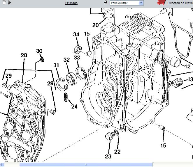

My 96 model 455 has developed a leak/seep/weep of transhydraulic fluid. I've looked a bit, but have not located the source. Curious if anybody else has encountered this? Almost looks like it's seeping at the parting line. It is dripping while it sits and wicking around on the floor. Not large amounts, just a mess.
/ 455 transaxle leak #2
It seems to be pretty common. There are three easy spots. The differential lock shaft seal (left side), the vent cap (top), and the swash plate shaft (right side). It can be a pain to work on so some people have found it easier to pull the transmission. It isn't too hard to remove the seat and the seat pan and lift the fuel tank off and set it in the foot rest. You will be able to see a lot better. People suggest cleaning the transmission case and using talcum powder to isolate the leak. There is a good thread on a transmission rebuild over at mtf. search for tuff torq k92. It might be worth while checking old posts here.

Looks like I need to do the wash/talc deal. Still looks to be leaking at the parting line. It's a slow drip while it sits. Seals for the various shafts look to be OK.

I had the same issue, mine was leaking on the PTO shaft and running down the case to what appeared to look as if the case was leaking. Mine would leak one day and then not the next too. I think that sometimes a little dirt/dust would soak up the oil so it appeared to not leak. Clean/power wash everything really good and then look closely for the leak. The PTO shaft seal was really easy to replace, I took a piece of pipe and used that to drive the new seal in.

Dustin, did you need to take the casing apart to get at the seal? or can it all be done from the outside?
/ 455 transaxle leak #11
I just did a 425 for a friend, his was leaking between the pump and housing. I had to remove the driveshaft from the engine to the transmission, then remote the 4 or 5 bolts and it was the seal/ring that went between the pump and transmission hydraulic pump. It fairly easy, I also worked at a deere dealer for 5 years and learned a lot.
/ 455 transaxle leak #12
No, the seal can be removed without doing anything besides taking the pto shaft off. I just used an o-ring pick to pull the old seal out and then turned down a piece of pipe to use as a seal driver. All done from the outside.
Also if anyone has a case leak, just save yourself sometime and remove the complete rearend. It is alot easier to work on then fighting it in the frame. Just my opinion.
Thanks, Dustin
