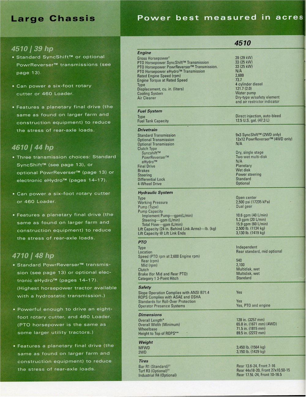

Discussed a 3320 vs 3520 in another thread. Anything I should know about a used 4510 as compared with these? I know it is a larger frame tractor similar to a 4120, but for the money (around $15k for an '02 w/ 700 hours) it might be worth it. It is a power reverser. With 30 or 40 acres to mow the bigger series might be useful..

They made 2WD & 4WD in that model. A 460 loader would be correct - a 400x may be retrofitted to it? I think that model had a non-turbo Yanmar engine and hydro was not optional. Probably a pretty good tractor. There should be others follow up soon with more info. Ah yes, it is on the large frame as 4610/4710.
All correct info. Here is some more..
