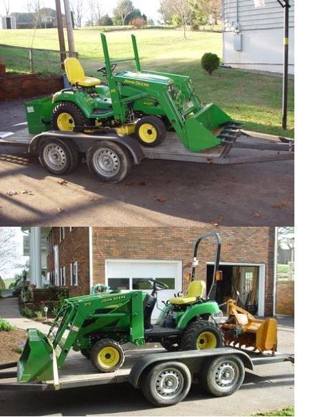

I'm looking at purchasing an X595 Series Tractor, and do allot of landscape work around our property. It sure would be nice to be able to have a loader for moving the bulk mulch, stone etc around. How useful is the 45 series loader on the X595? The Tractor seems a bit small for a loader attachment to me, but what the heck do I know. Oh, can anyone tell me why the Loader's frame uprights continue upward so high, beyond the top of the tractor itself? I've seen other similar loaders for similar size tractors that don't have the uprights sticking up like this, do they serve a legitimate purpose, or am I just going to get a football in the face one day when some wise **** kicks a field goal between them? Thanks all..
   / 45 Series Loader? #2
I had a X585 with a 45 loader and traded up to a 2210. The X series machines only have a hydrualic pressure of about 900 psi to run the loader where as it's bigger cousins operate at 1900+ effectively doubling the loader capacity.
In actual use I found the 45 loader to do alot of work. I would run out of steam though when trying to lift a bucket full of dirt(not loamy stuff but clayish red dirt) especially the loader arms. This would probably be true for gravel or sand also. It would be a little aggravating not being able to lift so I would have to back out or dump alittle to get it up- so to speak /forums/images/graemlins/smirk.gif
The goal post arms sticking up I believe is the roll over protection as the X series does not have a ROPS on the tractor. Although I have my doubts whether it would protect me.
The 45 loader is expensive so unless you can find a used one it just may be better to upgrade to a 2210 if you plan on using it for heavy stuff.
