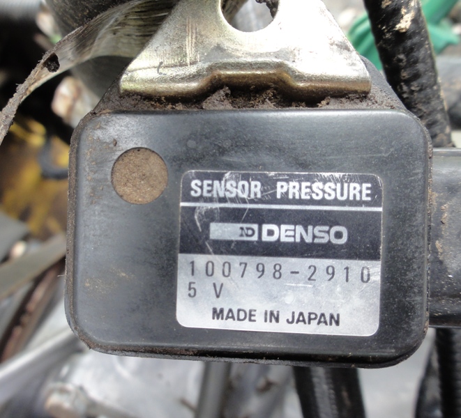

I don't have one. Does it have an O 2 sensor? These symptoms could suggest an O2 sensor on a fuel injected auto.
/ 445 loading up with fuel #10
No oxygen sensor.
/ 445 loading up with fuel #11
The fuel injector does have 2) O-rings.
