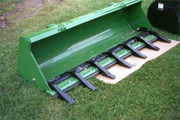

<font color=blue>I also want the dealer to put chain hooks on the bucket. 2 or 3, and where should they go.</font color=blue>
I'd put two on in the same general position as shown in the attachment. Make sure they are USA made and not the Chinese made hooks.

Thanks for the advice. The hooks I've got are made by Crosby in USA and are 3/8 inch. Ive also got 5/16 but I think the 3/8 are the ones I'll use.

The hooks I have on my buckets are 3/8". I think you'll find these to be more durable and effective than the 5/16, unless you already have the smaller link chain that can be accommodated by the 5/16" and don't won't to spend up to purchase 3/8" chains.
